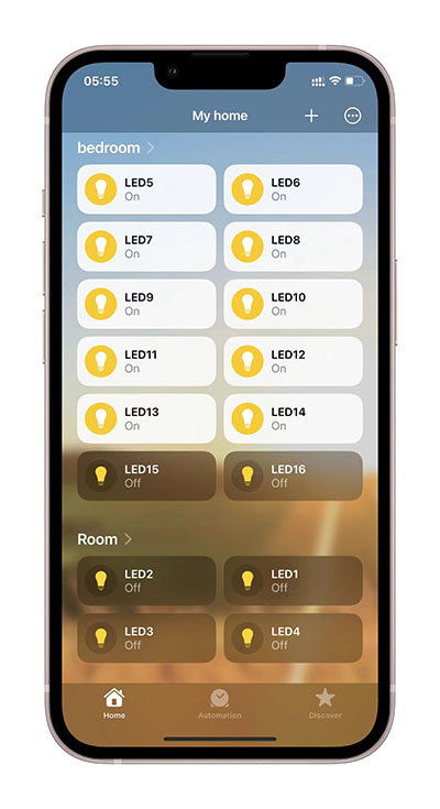

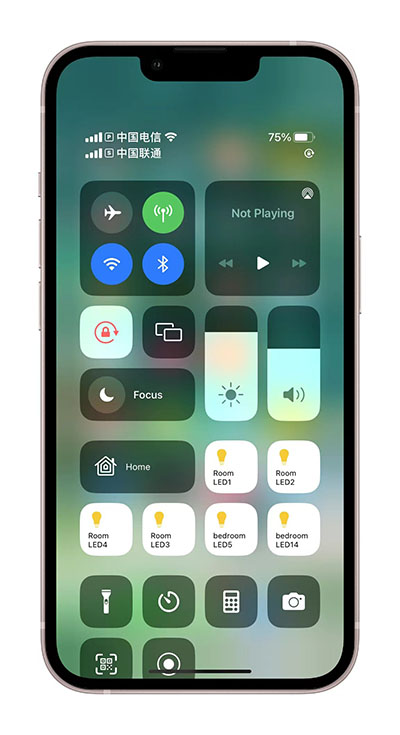

this arduino source code for KC868-E16S/KC868-E16T work with 16 relay and 16 momentary switch buttons via Apple homekit app. you can download the BIN firmware directly without chanage any code. Or you can open arduino source code project to compile. The source code use homespan library, mainly use PCF8574 extend GPIOs work with homespan.
[attachment=1446]
[attachment=1447][attachment=1448]

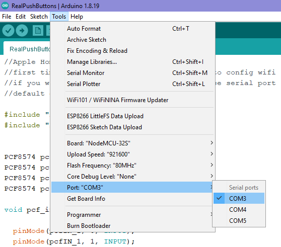

Set COM port in your arduino IDE "Tool" menu
