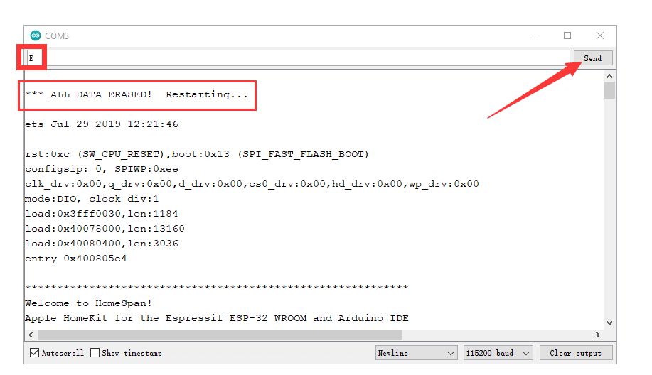

if you want to eraser all data , re-config homespan, then you can send "E" to serial port.
