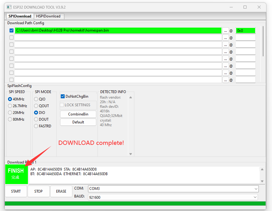

open ESP flash tool:
[attachment=1475]
[attachment=1719]
[attachment=1720]
now close ESP tool.
[attachment=1475]
[attachment=1719]
[attachment=1720]
now close ESP tool.
