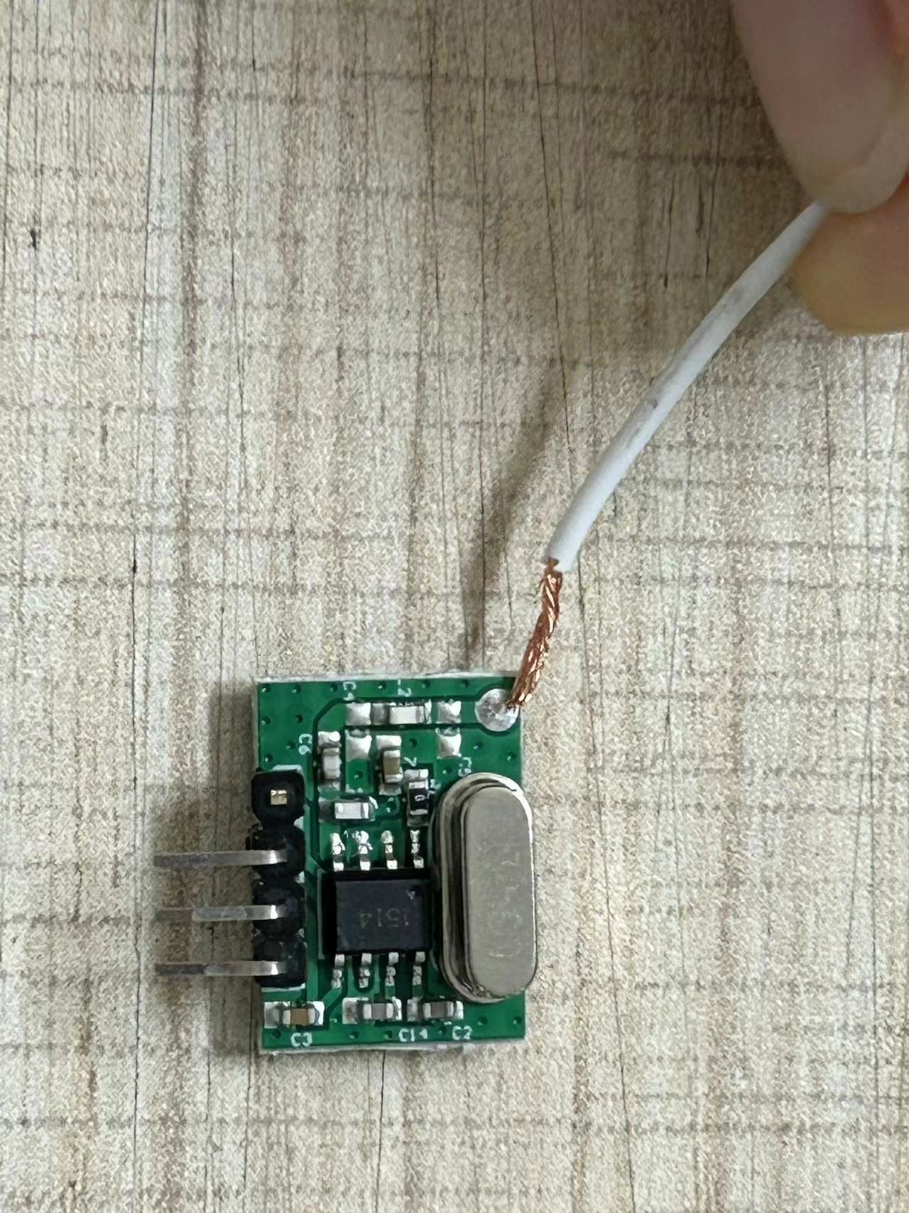

take a photo of your A8 board, whether have installed RF sender module?
I hope you now understand what I want. I need a button on the remote control for recording, a button for recording and turning off, and two test buttons for turning off and on, as in this code you prepared for me. KCS_KC868_A8_V2.0.2 I don't want to turn on RF lighting
i think you need solder an wire as antena on your RF sender module. if can't work, on weekend, i have free time, make a video tour for you, how to config RF sender learned signal with esphome.
