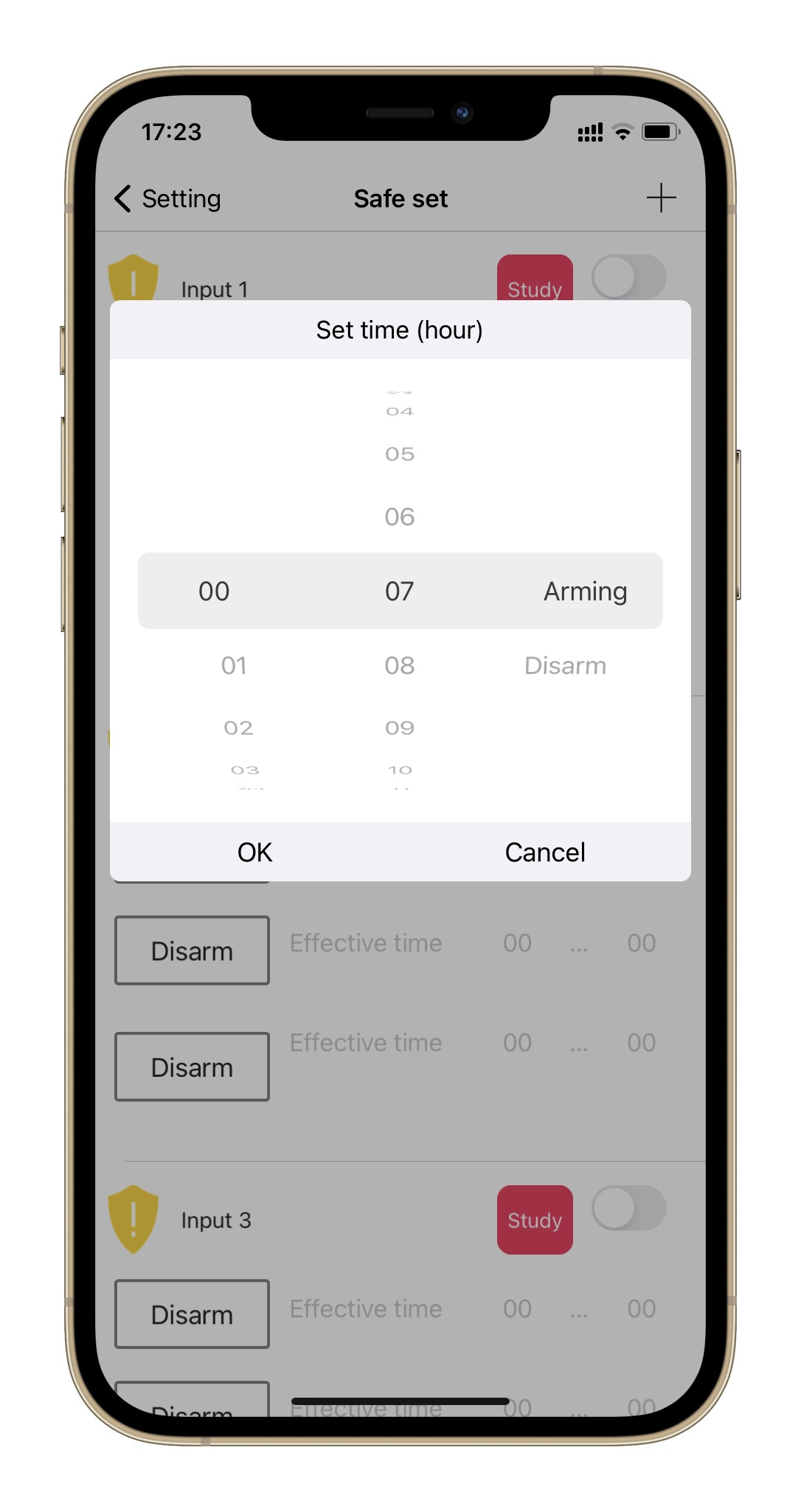

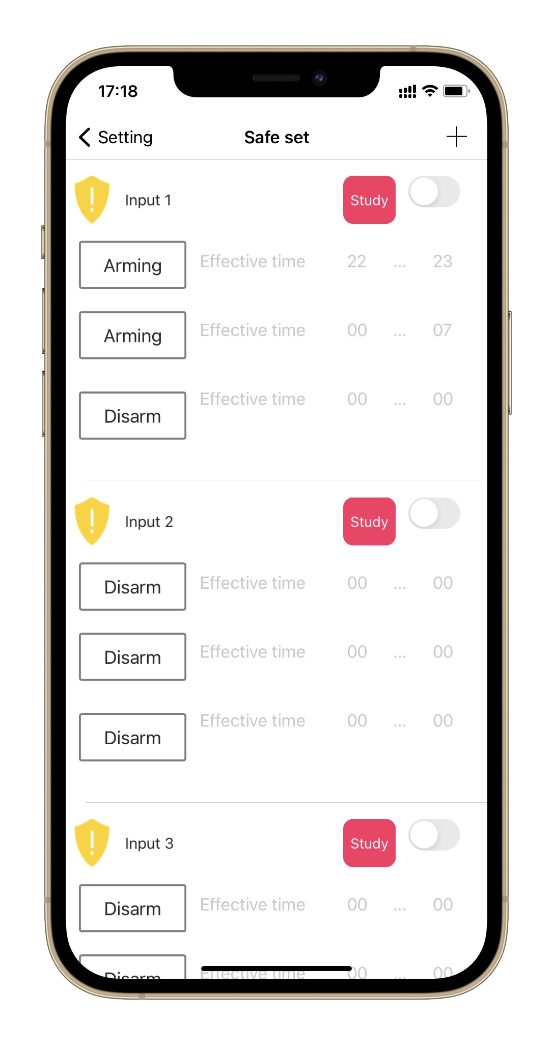

3: phone app- mine- Setting- Safe set- set the time range for begin and end. there are MAX 3 time range. Here is photo screen.
attachment=230][
attachment=231][
attachment=232]

I can activate the input via "safe set" in the time period I want (sin, it goes to hours ... no minutes) but then the light scene goes on ... but it does not turn off after 20 seconds as I would like.
