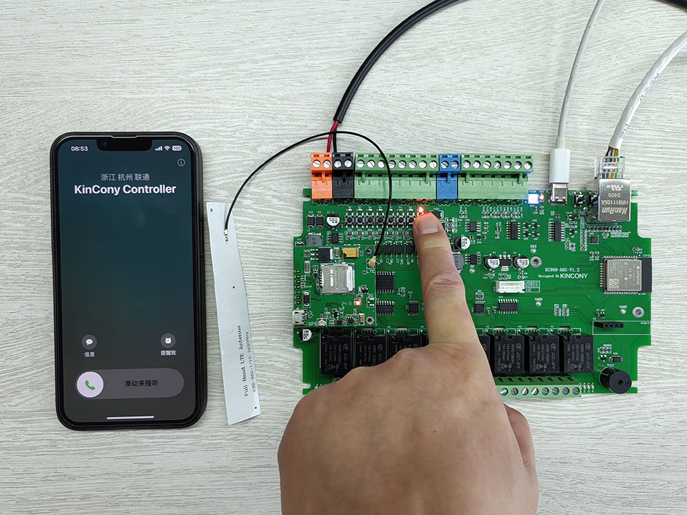

the ESPHome yaml demo made for KinCony KC868-A8S relay board. Actually you can use for any KinCony SIM7600 relay board, just replace 4G module's TXD,RXD define.
here is ESPHome yaml demo:

# UART configuration for SIM7600E
uart:
tx_pin: GPIO13
rx_pin: GPIO15
baud_rate: 115200
debug:
direction: BOTH
dummy_receiver: true
after:
timeout: 10ms
sequence:
- lambda: UARTDebug::log_string(direction, bytes);
binary_sensor:
- platform: gpio
on_press:
then:
- uart.write:
data: "ATD15381188302;\r\n" # Replace with the phone number you want to dial
pin:
pcf8574: pcf8574_hub_in_1
number: 0
mode: INPUT
inverted: true
