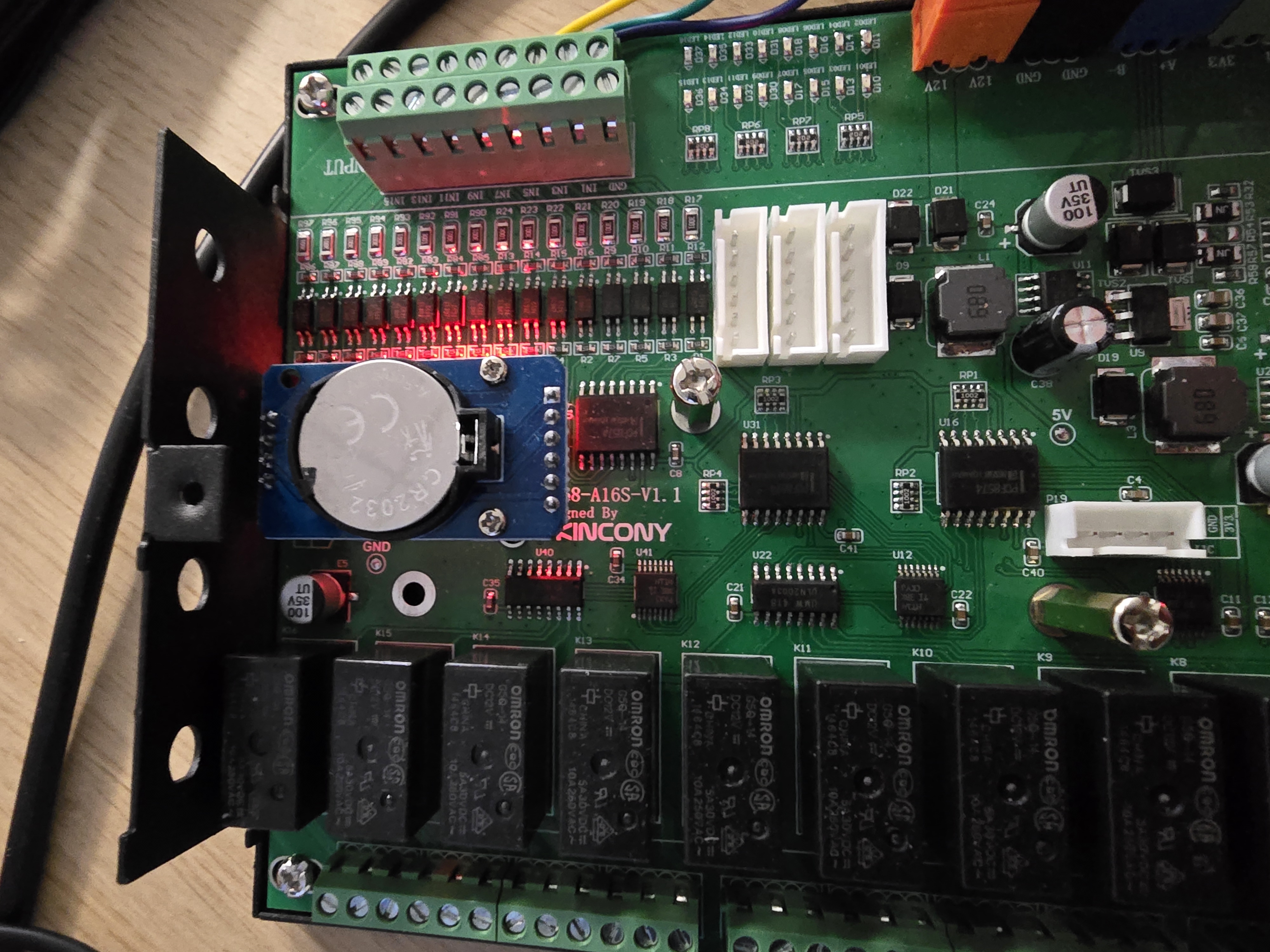

Posts: 12
Threads: 5
Joined: Nov 2022
Hi,
I have a same problem with KC868-16S, the right time zone is not correct.
Do you have a firmware for it ? I'm in 2.2.10
Thanks
Other question the DS3231 with a CR 2032 battery doesn't save the board time when reboot without internet ?
Thanks.
Posts: 10,276
Threads: 1,494
256
now DS3231 not used by KCS firmware, that use for user write own arduino source code.
