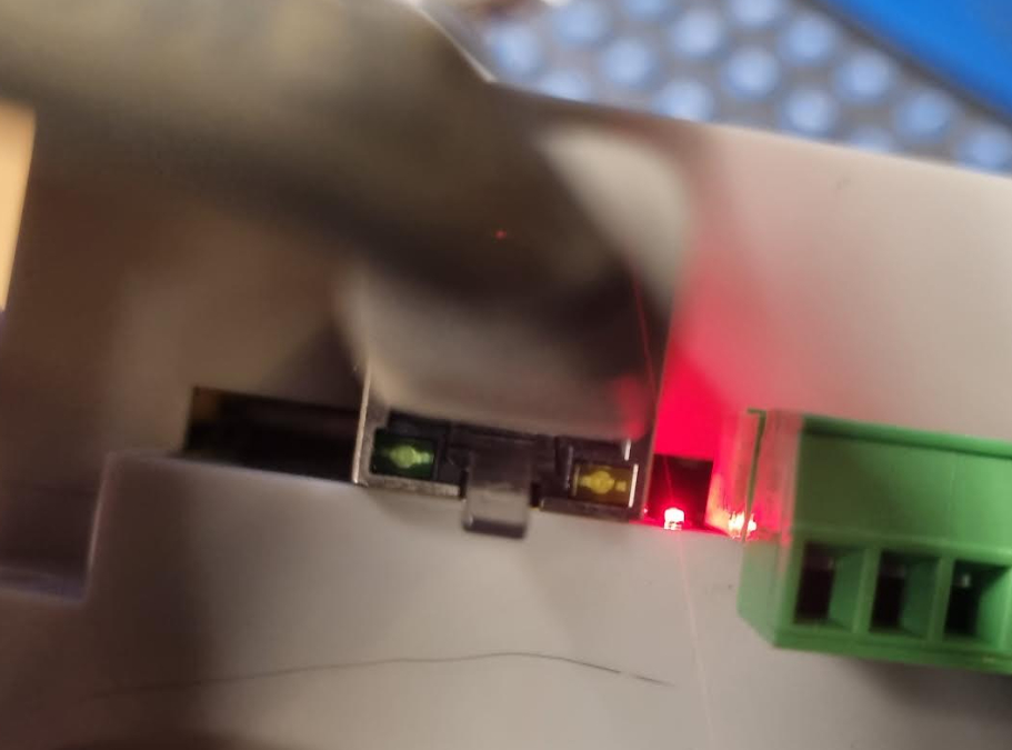

New unit!
Loaded KCS
(Loading .bin-files looks ok)
Running Scan_device
Do not find the KC868 or the IP-adress.
No lights at the network-connector!
Try to factory reset with >10sek. at download-button and/or reset-button
Is there any other way to factory-reset?
Is there any other way to get it to AP mode?
which board you are using? A16 or A16v3? green or blue pcb?
which KCS firmware you have downloaded?
