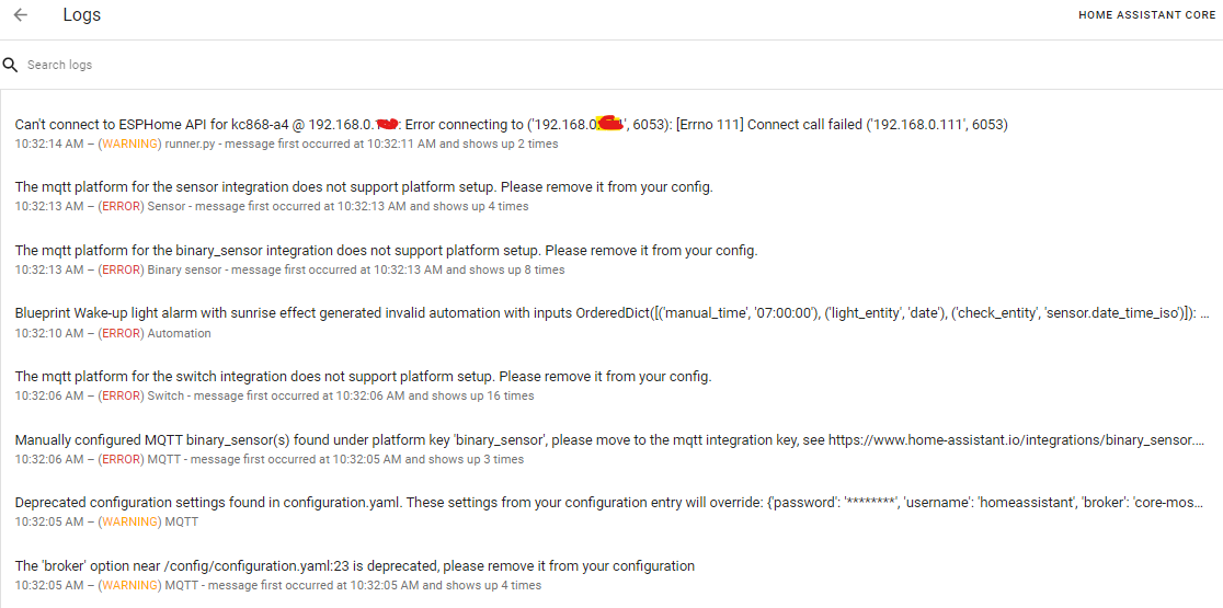

I have updated my KC868-server to Home Assistant 2022.12.0, now all my sensors and switches from my KC868-Server are "unavailable".
below is my sample configuration. Is the a new configuration for HA 2022.12.0, as they have been warning that this updates will affect the sensor.

try to delete these lines on yaml file:
broker: 192.168.0.118
port: 1883
username: mqtt
password: 1232332TESETEST
(12-13-2022, 07:51 AM)admin Wrote: try to delete these lines on yaml file:
  port: 1883
  username: mqtt
Not work yet.
See updated yaml config

update home assistant and ESPHome to the newest version, then update config file by error and warning message.

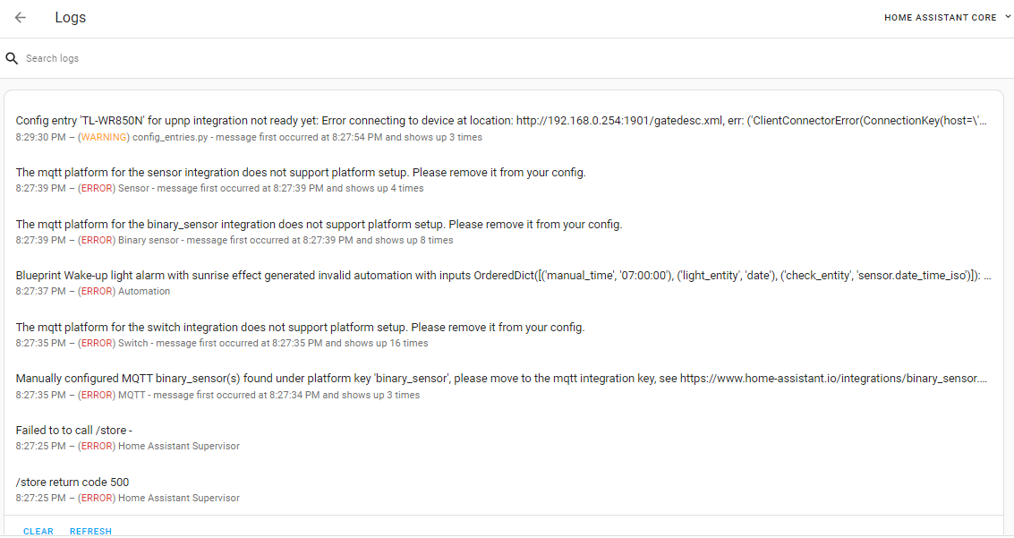

i have updated to the newest home assistant 2022.12.5 in KC868-Server. integrated 16 output and 16 digital input.
here is config file.
.txt   KC868-Server-home-assistant-MQTT_config_202212.txt (Size: 9.26 KB / Downloads: 410)

make sure your mosquitto MQTT broker have set correct setting IP address of KC868-Server.

Thank You. Recommendations worked. Also need to implement this recommendation "make sure your mosquitto MQTT broker have set correct setting IP address of KC868-Server. ". as part of the process I lost access to the KC868-Server, and used Device Scan to rediscover the IP address.
ok, great.
