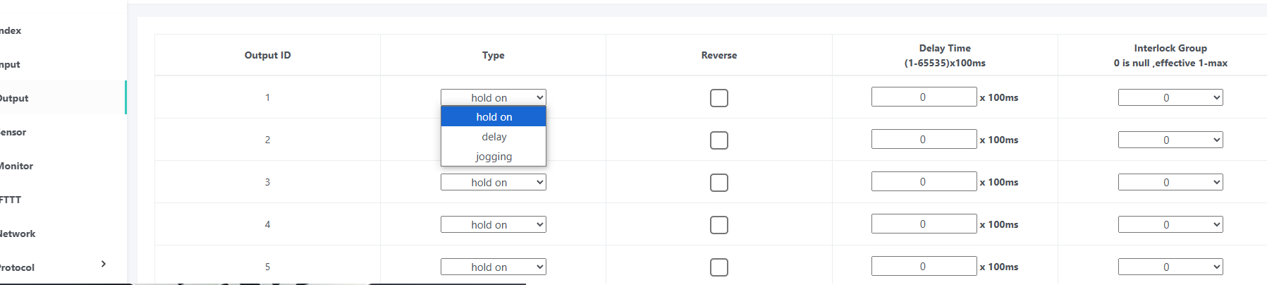

(03-19-2024, 11:13 AM)LTDU Wrote: Is it possible to turn an output on with timer via MQTT? E.g. turn on output1 for 1 second (then turn automatically off)?
You can use Delay option in KCS fw.
Outputs> Type> Delay
Then you configure the delay time.
