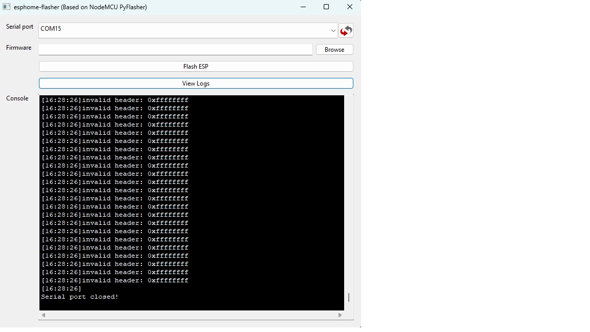

(02-23-2025, 08:34 AM)Hendrik Wrote: hi iam having the same problem, iam able to download a program to the device, but after restarting, the device is doing nothing, looks there is nothing inside.
tried to upload a very basic program (even tried to activate wifi) but still doing nothing.
download is goiing well, no errors
can you also support me with my issue?
downloading of the software is going well (llos that its going well) but after restart, the board is not comming up in esphome.
i use a 12Vdc power supply.
do you have tested with our esphome yaml file? if can't work, can you take a video of your problem. so that can understand deeply.
yes, iam able to upload the compiled yaml file to the unit,flashing is goiing well (looks like)
compile the yaml file inside esphome, and then upload it with esphome-flasher (use this for al the units.)
after that, i disconnect the usb, restart the unit, with a ethernet calbe plugged in, but nothing happens, its not showing up in my router and even not in esphome.
i can see the orange led blinking on the ethernet port, green led is going off (this one is on when there is no cable inside, which is strange for me, as its not on other modules)
after uploading, nothing happens, even after waiting a long time, there will be no log. after restarting the unit, and i tried to connect it to see the logs, but the com port is showing and disappering, looks like if there is abad connection or something. even the serial conection cannot open
Do these steps, whether can let S3 board enter BOOTLOADER mode again?
1. power off S3 board.
2. hold on S2 button (not release your finger)
3. power on S3 board.
4. release your finger.
5. connect USB-C cable to your computer.

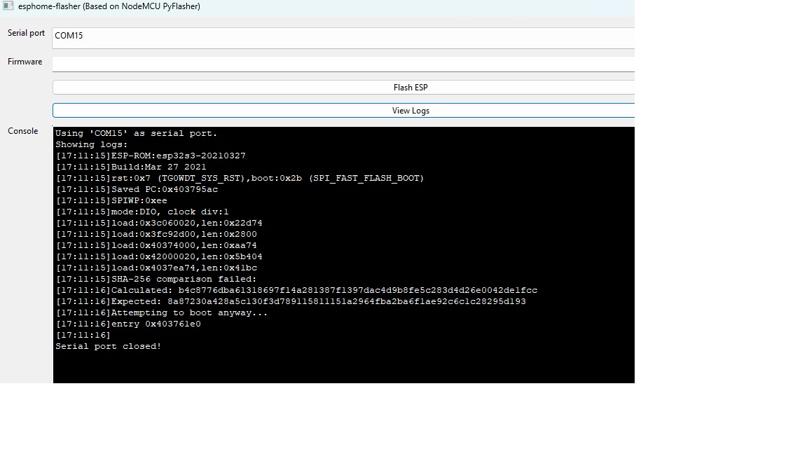

hi,
i tried this, but the same result. uploading is seeming goods, but the a reboot is failing it look likes
see screenshot for the fault which one i receive when i reboot and read the logs with a serial cable
