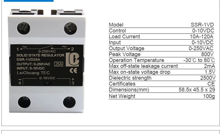

I'm testing the future setup of my home, I bought KC868-D16 for light dimmer and some Relay SSR Voltage Regulators.
I know that you always recommend the following relay (https://www.aliexpress.us/item/3256801518590551.html) to use with your board, but I it's much more expensive than alternatives I've found.
I have searched for the same spec:
  - 0-10VDC Control Input
  - 0-250VAC Output
There's any additional spec that I should pay attention when looking for alternative ? Because the relays that I've bought are not working, when I change the dimmer bar their led don't even power up....
The pictures of relays are attached.
I found the full spec of the ssr relays voltage regulator I have
when you use app change lamp brightness = 100%, lamp can't ON?
(12-04-2023, 10:39 PM)admin Wrote: when you use app change lamp brightness = 100%, lamp can't ON?
No, lamp doesn’t turn on.
draw a diagram, how you connect with wire.
The issue was that the load was < 50W.
I was trying with a led bulb of 10W, change to one of 60W works.
The doubt that remains is what to do if I need to dimmer a circuit of 4 led bulbs of 10W each ?
our SSR need >18W load. maybe your SSR is different.
(12-07-2023, 02:29 PM)admin Wrote: our SSR need >18W load. maybe your SSR is different.
I have additional questions:
When you say "our SSR" is that one ?
https://pt.aliexpress.com/item/100500170...pt=glo2bra
Even when using your SSR, what can I do if I need to dimmer < 18W ?
What information should I pay attention on the SSR specs to know the load need to work ?
yes, that link we have tested, other brand we have not used, it's not easy to say whether work well.
(02-05-2024, 12:22 PM)admin Wrote: yes, that link we have tested, other brand we have not used, it's not easy to say whether work well.
Ok. But how to make a < 18w load work your ssr ?
if you use "tungsten wire type" light bulb, not MUST >18W. you can add whatsapp number:  +86-15381188302  i can send you a video D16 work with SSR and bulb.
