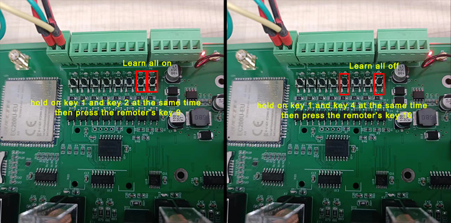

how to learn RF signal:
[Image: attachment.php?aid=2714]
[Image: attachment.php?aid=2897]
