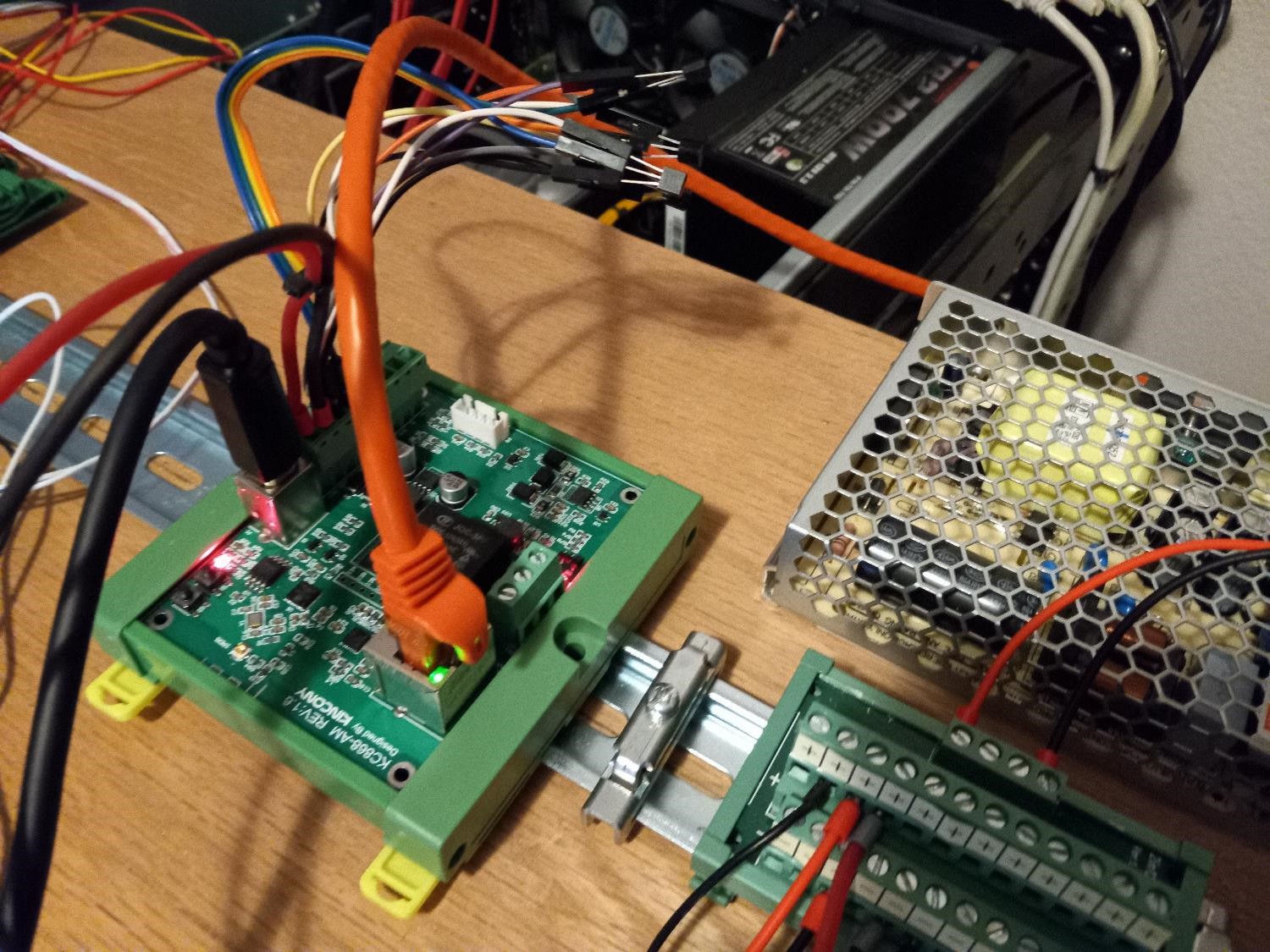

Don't use  WhatsApp. I have attached two pictures of my configuration. Works fine with ESPHome, but I want to use KCS firmware because I like the extra features it has.
I have noticed in MQTT Explorer that the published MQTT string has an extra comma before "output1".  {,"output1":{"value":true},"sensor1":{"temperature":78.3,"humity":-100.0},"sensor2":{"temperature":78.8,"humity":-100.0},"sensor3":{"temperature":78.6,"humity":-100.0},"sensor4":{"temperature":78.6,"humity":-100.0}}
This seems to affect the JSON format so I don't know if it is supposed to be there or is it a bug in the firmware.
I have circled it in red in the image.

ok, i see now, we will check, update firmware.
do you use 3pcs of DS18B20 with 3 GPIOs?

tested as photo:
{"output1":{"value":false},"sensor1":{"temperature":28.2,"humity":-100.0},"sensor2":{"temperature":-100.0,"humity":-100.0},"sensor3":{"temperature":-100.0,"humity":-100.0},"sensor4":{"temperature":-100.0,"humity":-100.0}}
if have value -100.0 that means sensor not connected.
