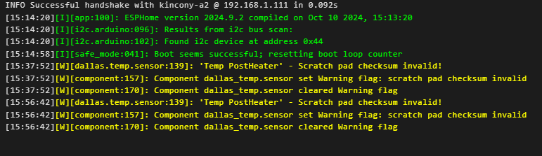

Perhaps you misunderstood me. I receive data from the sensor, but from time to time the sensor sends a warning in the logs “Scratch pad checksum invalid!” and the connection with it is lost for one sensor update interval (in my case, 5 seconds). This can happen either 3-5 minutes after launching or 15-20 minutes later, there is no regularity. To make sure that everything is fine, you need to connect the detector and leave the log for 1 hour, and then check if everything is fine. But the fact that these warnings appear in the logs must mean something. As I mentioned above, I don't get these warnings on my other D1 Mini board.
Your example didn't work either. Could something on the A2 board be damaged and affect the warnings from the DS18B20 sensor?

Are you suggesting that there might be a problem with the resistors? I can solder other 4.7K and 100Ω resistors in their place, but I have standard resistors with legs, not SMD. But before that, can I somehow make sure that the resistors on the board are not working properly?
