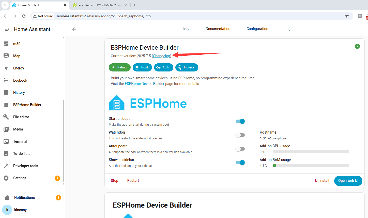

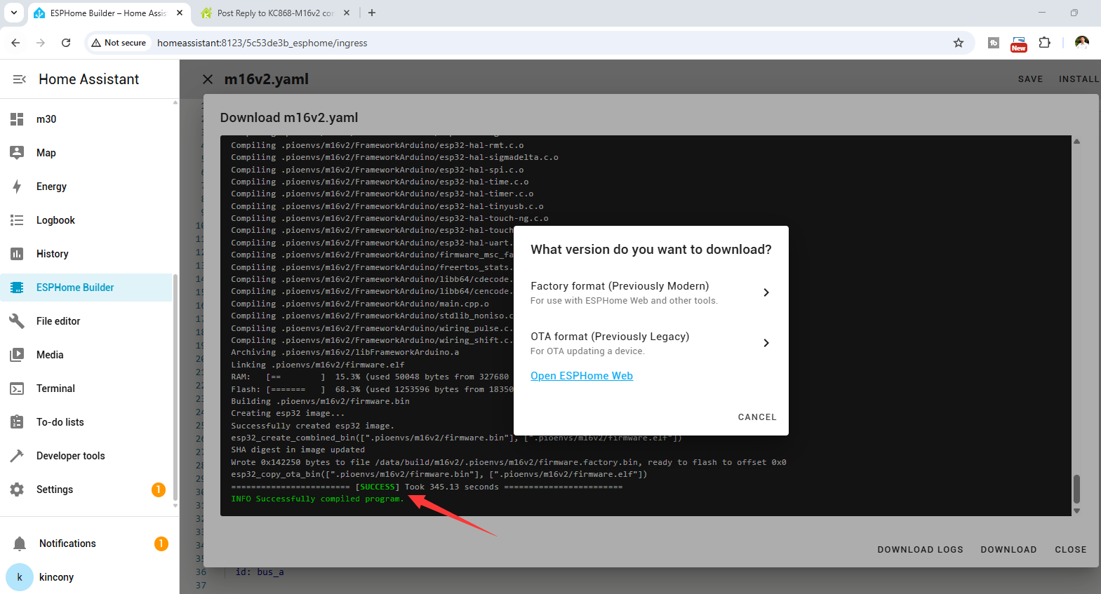

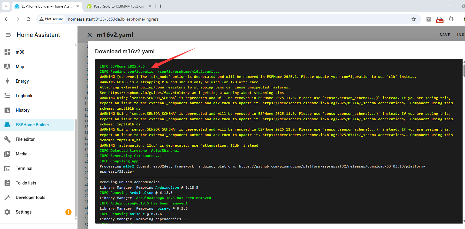

#95
tested again with home assistant add-on ESPHome 2025.7.5
#96
(08-25-2025, 11:07 PM)admin Wrote: tested again with home assistant add-on ESPHome 2025.7.5

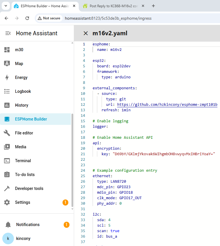

#97
this is yaml file have tested.
.txt   M16v2-yaml-ESPHome.txt (Size: 9.26 KB / Downloads: 286)

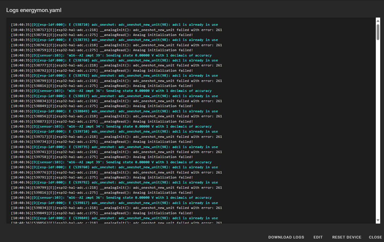

(08-29-2025, 03:25 PM)carrrettamarco Wrote:
(08-27-2025, 10:35 AM)admin Wrote: this is yaml file have tested.
Is this software compatible with the newest version of Home Assistant?
Hello Admin,
I just tried now the latest version but is it still not working. Attached screeshot.
[10:40:35][D][esp-idf:000]: E (538710) adc_oneshot: adc_oneshot_new_unit(98): adc1 is already in use
[10:40:35][538717][E][esp32-hal-adc.c:218] __analogInit(): adc_oneshot_new_unit failed with error: 261
[10:40:35][538734][E][esp32-hal-adc.c:275] __analogRead(): Analog initialization failed!
[10:40:35][D][esp-idf:000]: E (538735) adc_oneshot: adc_oneshot_new_unit(98): adc1 is already in use
[10:40:35][538742][E][esp32-hal-adc.c:218] __analogInit(): adc_oneshot_new_unit failed with error: 261
[10:40:35][538759][E][esp32-hal-adc.c:275] __analogRead(): Analog initialization failed!
[10:40:35][D][sensor:103]: 'm16--AI zmpt 39': Sending state 0.00000 V with 1 decimals of accuracy
[10:40:35][D][esp-idf:000]: E (538760) adc_oneshot: adc_oneshot_new_unit(98): adc1 is already in use
[10:40:35][538777][E][esp32-hal-adc.c:218] __analogInit(): adc_oneshot_new_unit failed with error: 261
[10:40:35][538792][E][esp32-hal-adc.c:275] __analogRead(): Analog initialization failed!
[10:40:35][D][esp-idf:000]: E (538792) adc_oneshot: adc_oneshot_new_unit(98): adc1 is already in use
[10:40:35][538799][E][esp32-hal-adc.c:218] __analogInit(): adc_oneshot_new_unit failed with error: 261
[10:40:35][538816][E][esp32-hal-adc.c:275] __analogRead(): Analog initialization failed!
[10:40:35][D][sensor:103]: 'm16--AI zmpt 36': Sending state 0.00000 V with 1 decimals of accuracy
[10:40:35][D][esp-idf:000]: E (538817) adc_oneshot: adc_oneshot_new_unit(98): adc1 is already in use
[10:40:35][538834][E][esp32-hal-adc.c:218] __analogInit(): adc_oneshot_new_unit failed with error: 261
[10:40:35][538849][E][esp32-hal-adc.c:275] __analogRead(): Analog initialization failed!
[10:40:35][D][esp-idf:000]: E (538849) adc_oneshot: adc_oneshot_new_unit(98): adc1 is already in use
[10:40:35][538856][E][esp32-hal-adc.c:218] __analogInit(): adc_oneshot_new_unit failed with error: 261
[10:40:35][538873][E][esp32-hal-adc.c:275] __analogRead(): Analog initialization failed!
[10:40:35][D][sensor:103]: 'm16--AI zmpt 34': Sending state 0.00000 V with 1 decimals of accuracy
[10:40:36][D][esp-idf:000]: E (539710) adc_oneshot: adc_oneshot_new_unit(98): adc1 is already in use
[10:40:36][539717][E][esp32-hal-adc.c:218] __analogInit(): adc_oneshot_new_unit failed with error: 261
[10:40:36][539734][E][esp32-hal-adc.c:275] __analogRead(): Analog initialization failed!
[10:40:36][D][esp-idf:000]: E (539735) adc_oneshot: adc_oneshot_new_unit(98): adc1 is already in use
[10:40:36][539741][E][esp32-hal-adc.c:218] __analogInit(): adc_oneshot_new_unit failed with error: 261
[10:40:36][539758][E][esp32-hal-adc.c:275] __analogRead(): Analog initialization failed!
[10:40:36][D][sensor:103]: 'm16--AI zmpt 39': Sending state 0.00000 V with 1 decimals of accuracy
[10:40:36][D][esp-idf:000]: E (539760) adc_oneshot: adc_oneshot_new_unit(98): adc1 is already in use
[10:40:36][539776][E][esp32-hal-adc.c:218] __analogInit(): adc_oneshot_new_unit failed with error: 261
[10:40:36][539791][E][esp32-hal-adc.c:275] __analogRead(): Analog initialization failed!
[10:40:36][D][esp-idf:000]: E (539792) adc_oneshot: adc_oneshot_new_unit(98): adc1 is already in use
[10:40:36][539799][E][esp32-hal-adc.c:218] __analogInit(): adc_oneshot_new_unit failed with error: 261
[10:40:36][539816][E][esp32-hal-adc.c:275] __analogRead(): Analog initialization failed!
[10:40:36][D][sensor:103]: 'm16--AI zmpt 36': Sending state 0.00000 V with 1 decimals of accuracy
[10:40:36][D][esp-idf:000]: E (539817) adc_oneshot: adc_oneshot_new_unit(98): adc1 is already in use
[10:40:36][539834][E][esp32-hal-adc.c:218] __analogInit(): adc_oneshot_new_unit failed with error: 261
[10:40:36][539849][E][esp32-hal-adc.c:275] __analogRead(): Analog initialization failed!
[10:40:36][D][esp-idf:000]: E (539849) adc_oneshot: adc_oneshot_new_unit(98): adc1 is already in use
[10:40:36][539856][E][esp32-hal-adc.c:218] __analogInit(): adc_oneshot_new_unit failed with error: 261
[10:40:36][539873][E][esp32-hal-adc.c:275] __analogRead(): Analog initialization failed!
[10:40:36][D][sensor:103]: 'm16--AI zmpt 34': Sending state 0.00000 V with 1 decimals of accuracy
[10:40:36][D][sht3xd:095]: Got temperature=26.34°C humidity=66.59%
[10:40:36][D][sensor:103]: 'sht Temperature': Sending state 26.34051 °C with 1 decimals of accuracy
[10:40:36][D][sensor:103]: 'sht Humidity': Sending state 66.58884 % with 1 decimals of accuracy
[10:40:36][D][ct_clamp:041]: 'Measured Current-1' - Raw AC Value: 0.003A after 446 different samples (2230 SPS)
[10:40:36][D][sensor:103]: 'Measured Current-1': Sending state 0.00097 A with 2 decimals of accuracy
[10:40:37][D][esp-idf:000]: E (540710) adc_oneshot: adc_oneshot_new_unit(98): adc1 is already in use
