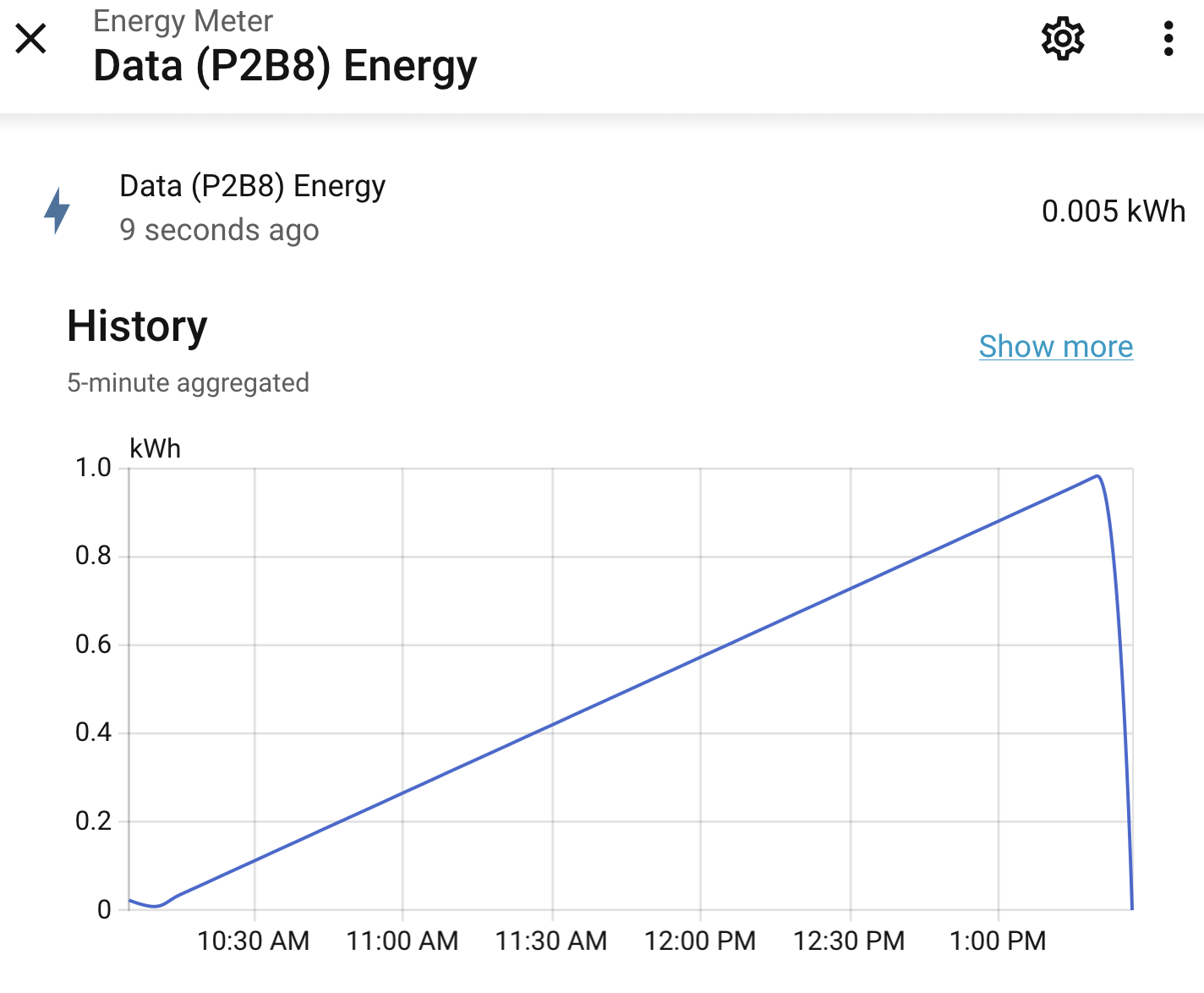

Unfortunately, kWh data is still being reset on power cycle:
Here I let me server cabinet run for a while, accumulate some stats, and then I power cycled the device. You can see that the next reported stat is 0.01kwh.
(The only reason it did not report "0.0kwh" is because I added a bit of YAML to prevent that.)
The YAML for the data above is reported through this YAML:

(I do this because some sources combine multiple CT's, like 240 split phase loads like my EV charger and it all runs through the same "hide the ct, combine the outputs" script regardless of how many input ct's there are)
However, the CT on modbus at "address: 348" did come back with saved values. Many other's did as well; I don't have a comprehensive list, though. I could figure that out if needed.
What I suspect: Is it possible the firmware update isn't storing all the values for the expanded scope of the N60?
Thanks!
