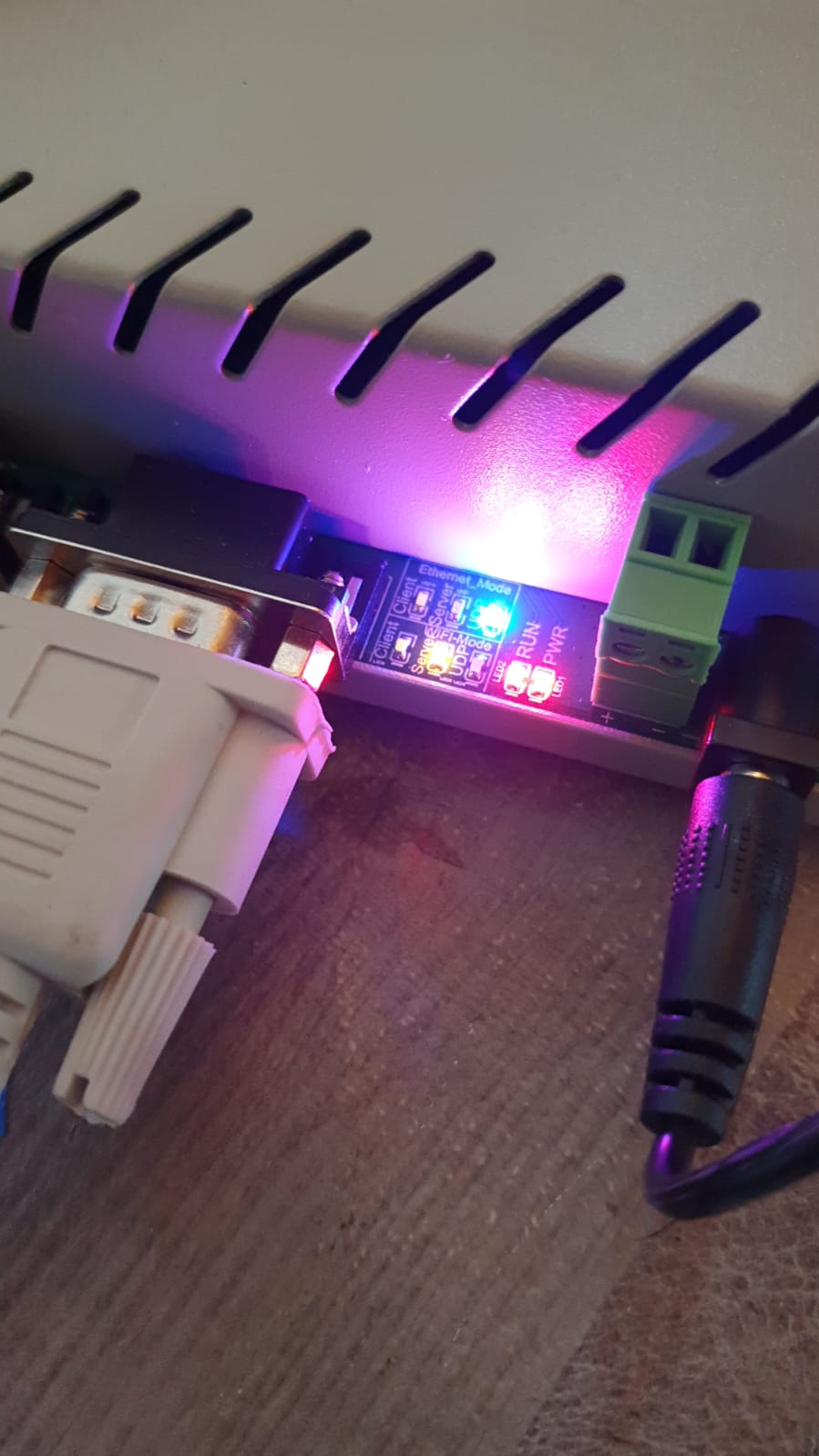

about to config ethernet mode in tcp client I will send you picure because withe led it's on only in MQTT mode

take a photo of your controller and network setting screen photo to me.

Here photos

(03-10-2022, 01:47 PM)admin Wrote: ok, tomorrow we check.
led became white only in mqtt mode
#29
next firmware version will update it .
