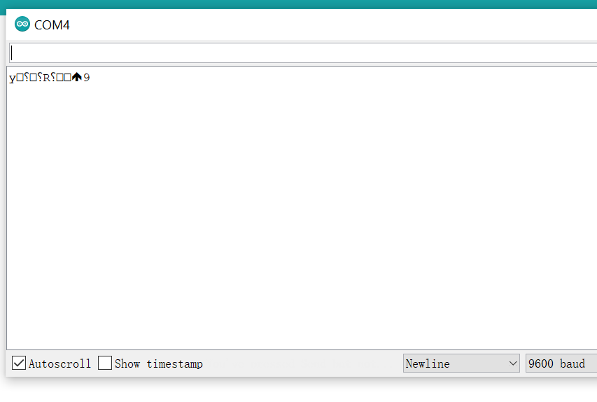

Hello engineer .
when I upload the KBOX code gave me litters in serial monitor like that in attached photo .
and also IR code same letters . I don't know what's problem .
so what's error I made ?
please help .

check your code: Serial.begin(115200); but your serial monitor using 9600bps, change to 115200bps.

yes Engineer its okay after changing same you say.
