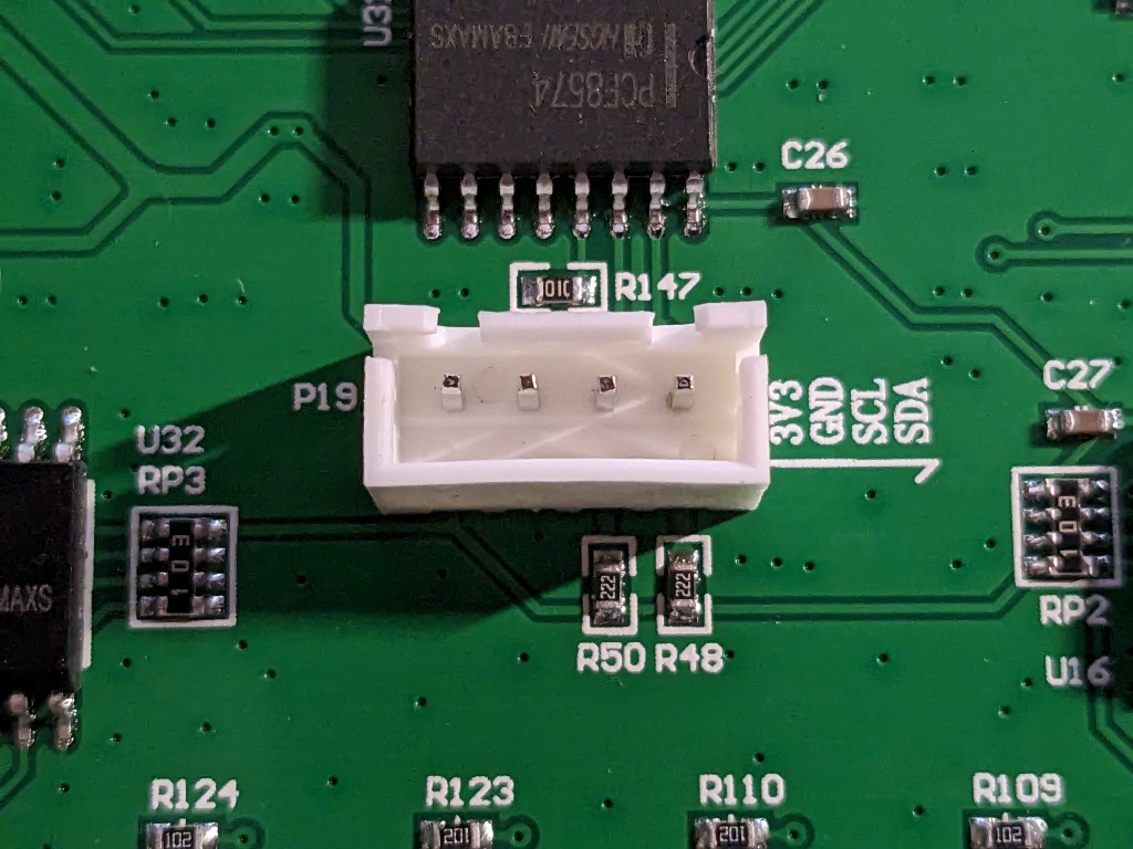

I am looking at adding a DS1307 RTC connected via I2C, anyone you can recommended that has been testet and easy to connect?
Presume source code are the same as for the KC868-A6.

any DS1307 chip can use, just define correct I2C bus pins is ok.

you can use "DuPont Line" connect with each pins.

IIC SDA:4
IIC SCL:5
you should set it in your arduino "pins_arduino.h" file set SDA and SCL pins.
