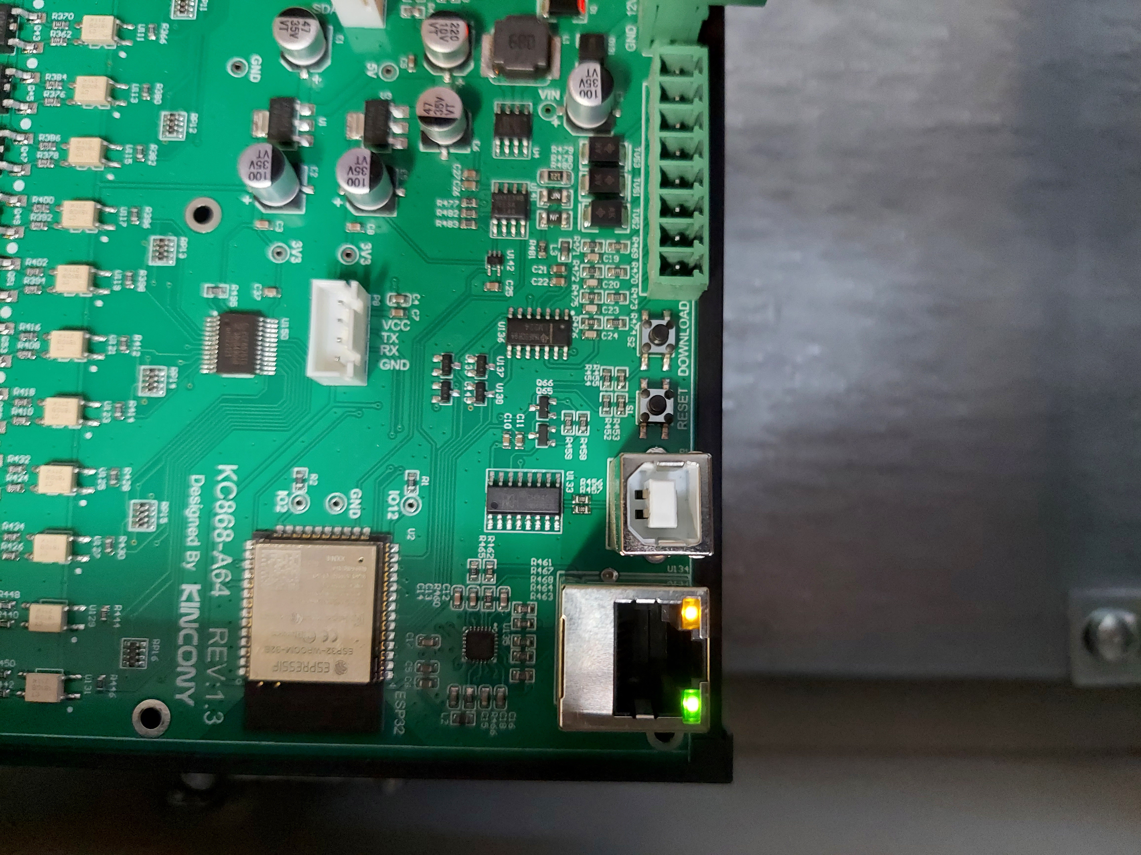

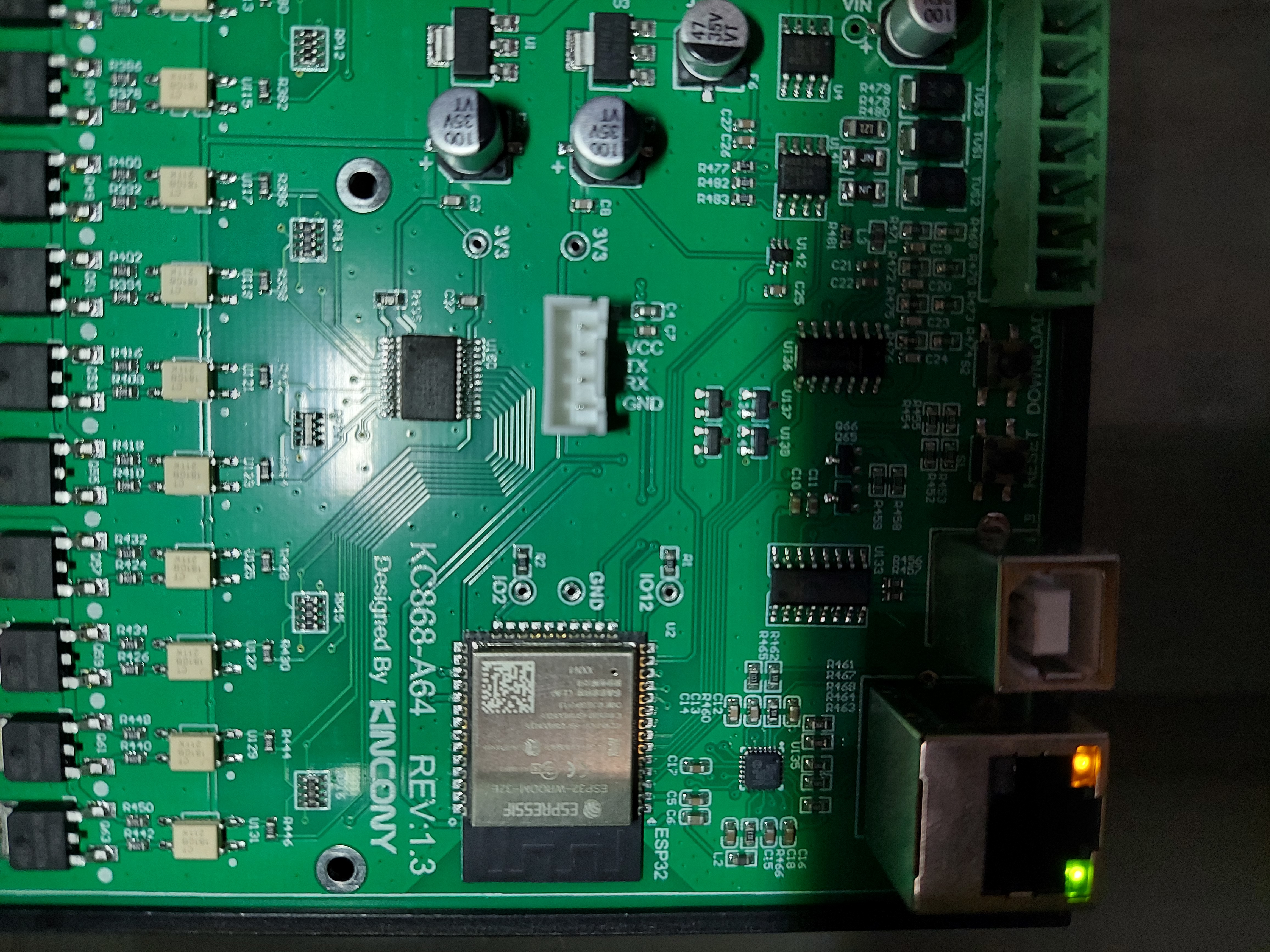

can you  take a  photo of your A64 board about the Ethernet port? we think the chip of ethernet maby something wrong with it
Here are the pictures
As I understand the board hardware is defective.
The board is ca 5 months old, do I have a warranty for this board?
