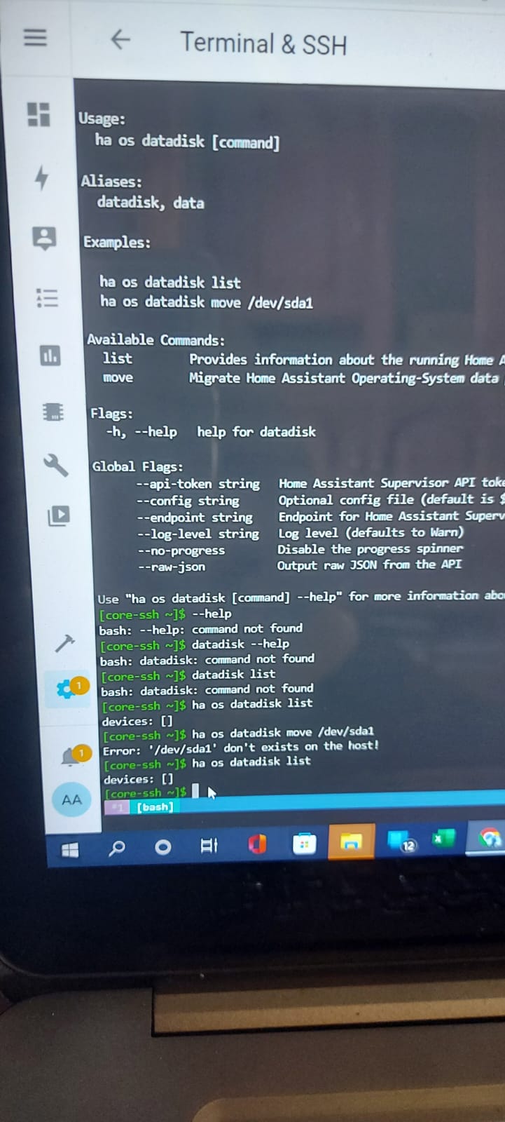

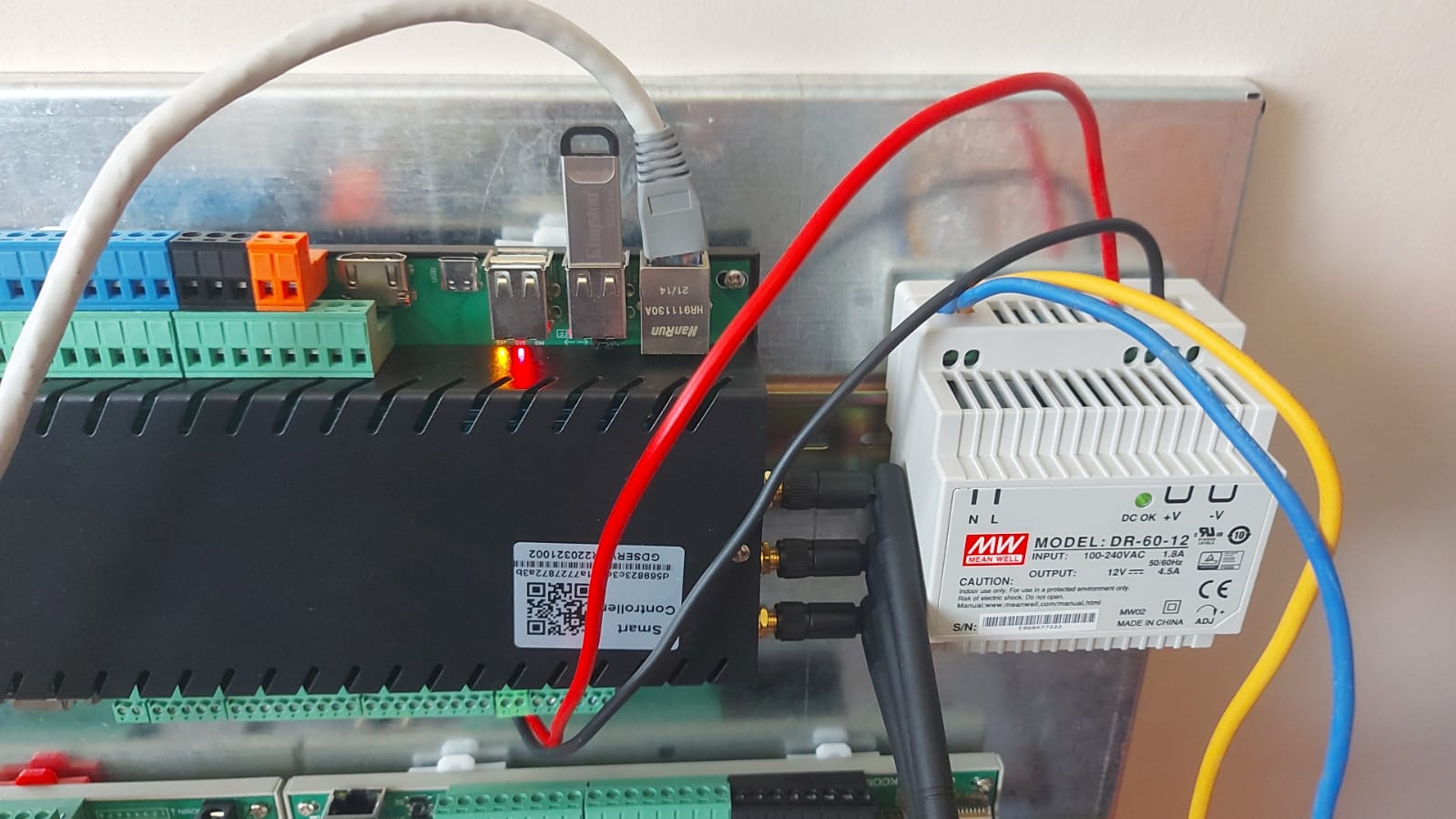

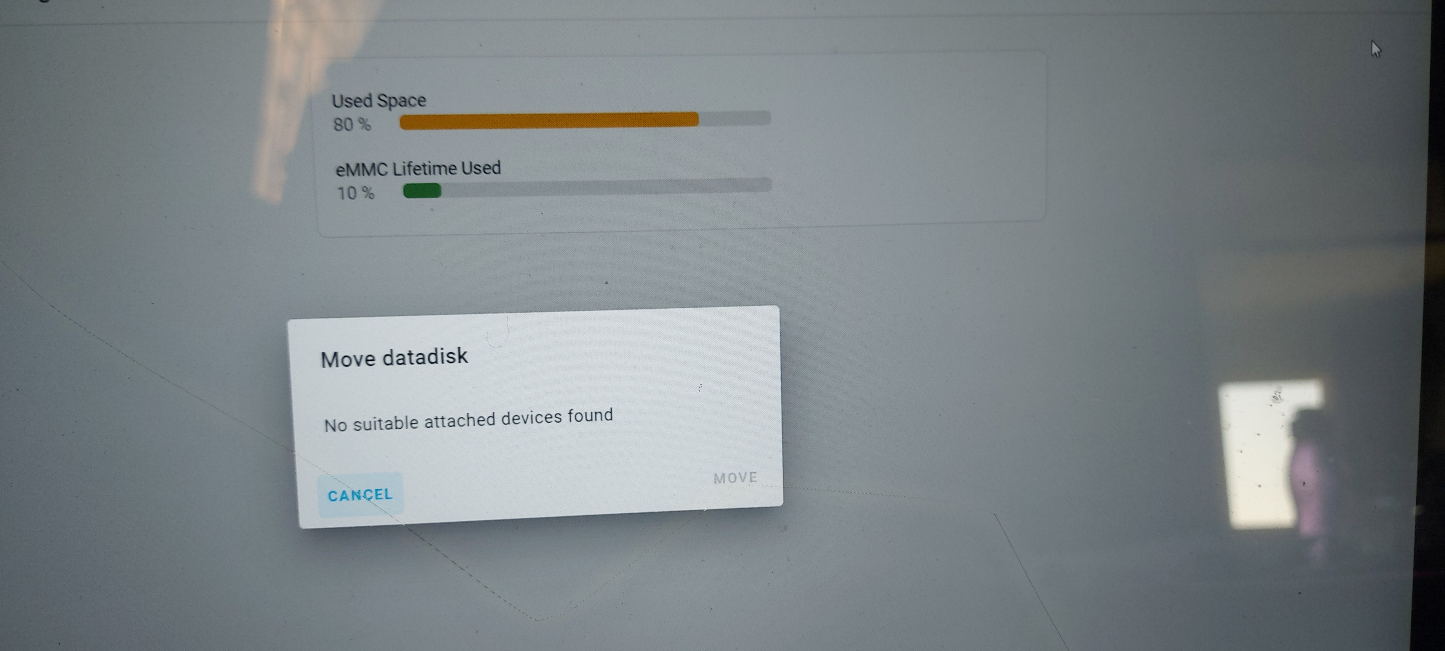

- Samba and file Editor other add-on need it has been installed please see attached snapshot until the server disk space get not enough then i didn't complete this part as i desired.

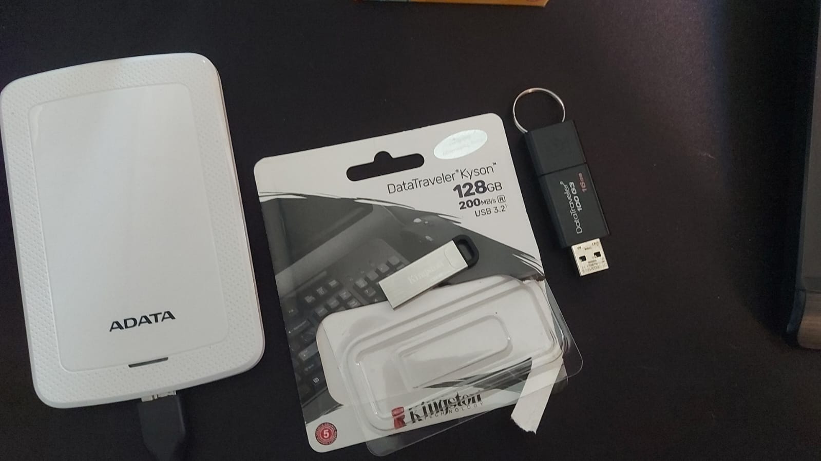

- I asked question and how much size of USB memory stick or hard disk i can connect and how to move the data to it, your answer review the maximum size that you can connect to the server and you sent me this link https://www.home-assistant.io/common-tasks/os/
But in the link no information on the maximum usb storages that i can connect.
- how this will be fast as well for executing the commands without delay? bearing in mind that all 4 USB for Raspberry pi side are USB 2 the white not the blue on USB 3.0 !

Using diferent data disk types and sizes.
Using 4.5 A ac/dc converter 12 v instead of normal kincony 12 v
I exhausted my times and trial please send quck anydisk apoijnt m ent to move forward.

do you have enable the USB port for CM4 firstly?
To enable the USB 2.0 ports on the Compute Module 4, you need to edit the boot config file (/boot/config.txt) and add:
dtoverlay=dwc2,dr_mode=host
Then reboot the Pi. Now you should be able to use the built-in USB 2.0 ports!

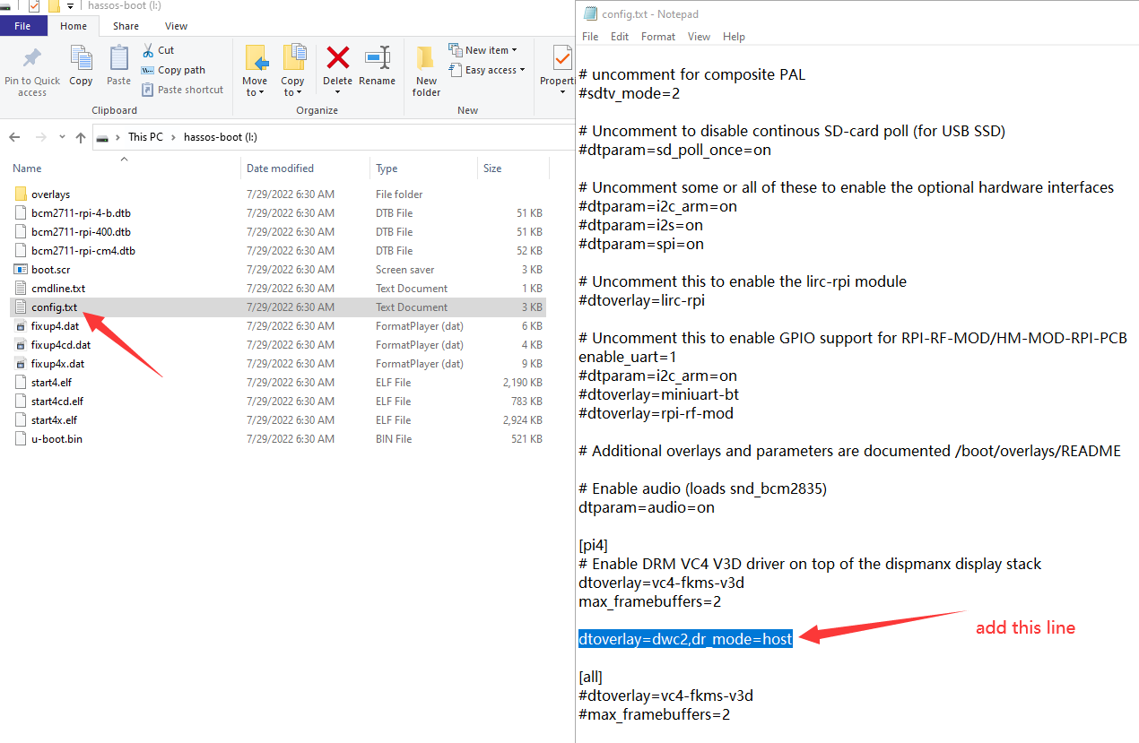

#24

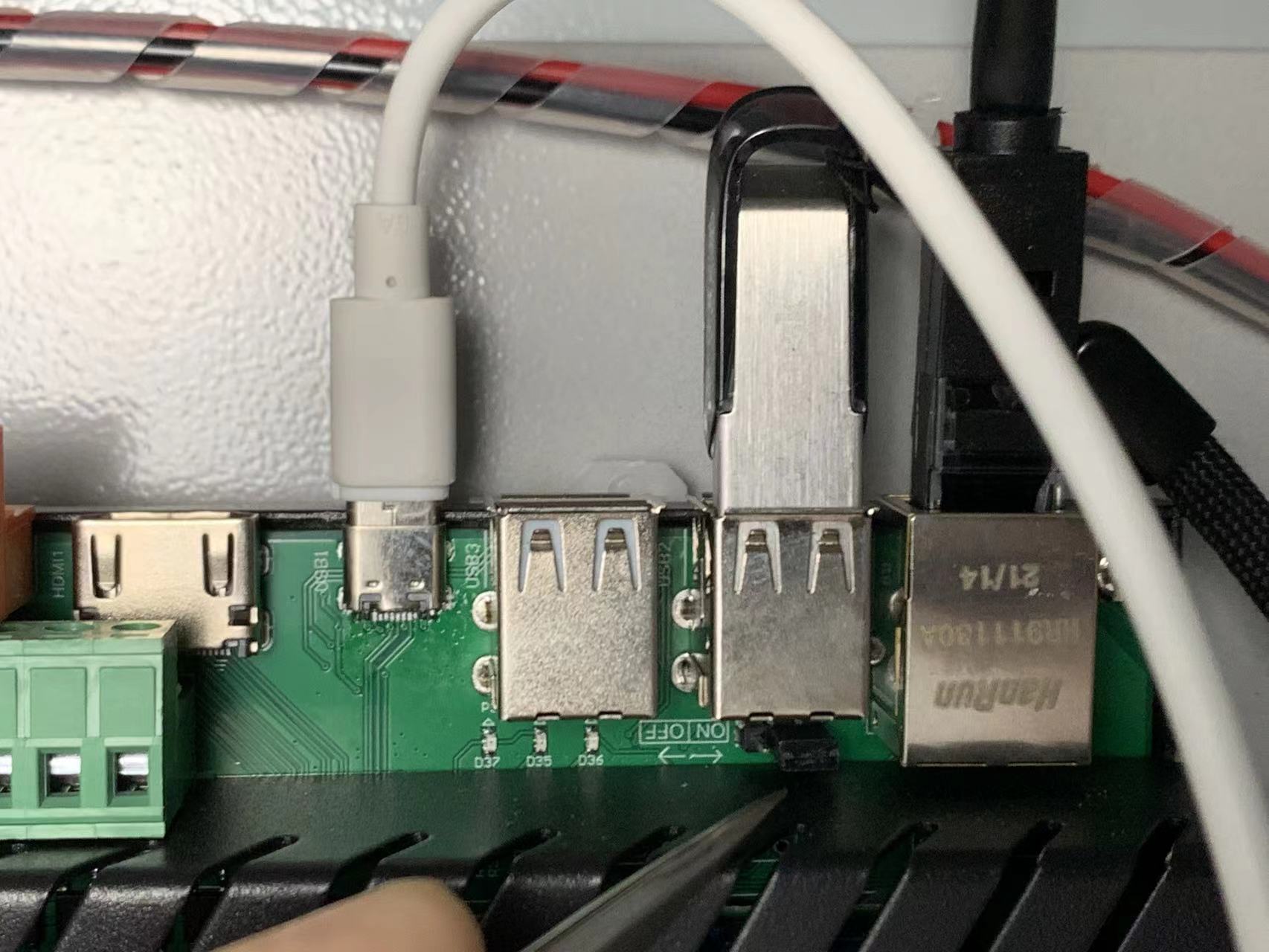

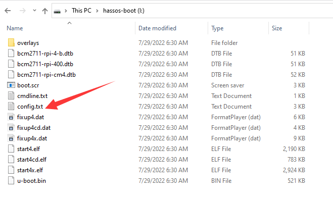

here is config.txt file in KC868-Server. you can replace for your file.
our work time is : 8:30AM -- 5:00PM in China, during these time, we can use anydesk help you.
because you replace file need change JUMPER and reboot, so do it by yourself is more easy.
If you want to engage in smart home business for a long time, it is inevitable to learn basic knowledge.
Here are some steps how to update file to enable USB port of CM4.

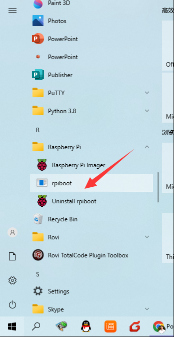

1. change KC868-Server CM4 boot jumper to "ON"/RIGHT, see photo, connect USB-C cable with your computer.
2. power on of your KC868-Server, open program rpiboot in your windows OS.
3. in my PC will scaned new disk for CM4 eMMC driver. you will find out "config.txt"
4. you can add command line or just replaced with my config.txt file.
.txt   config.txt (Size: 2.07 KB / Downloads: 476)

Thanks finallh resolved, please add this part to the installation document of Rasspery pi4
Can't expect this issue at all !!

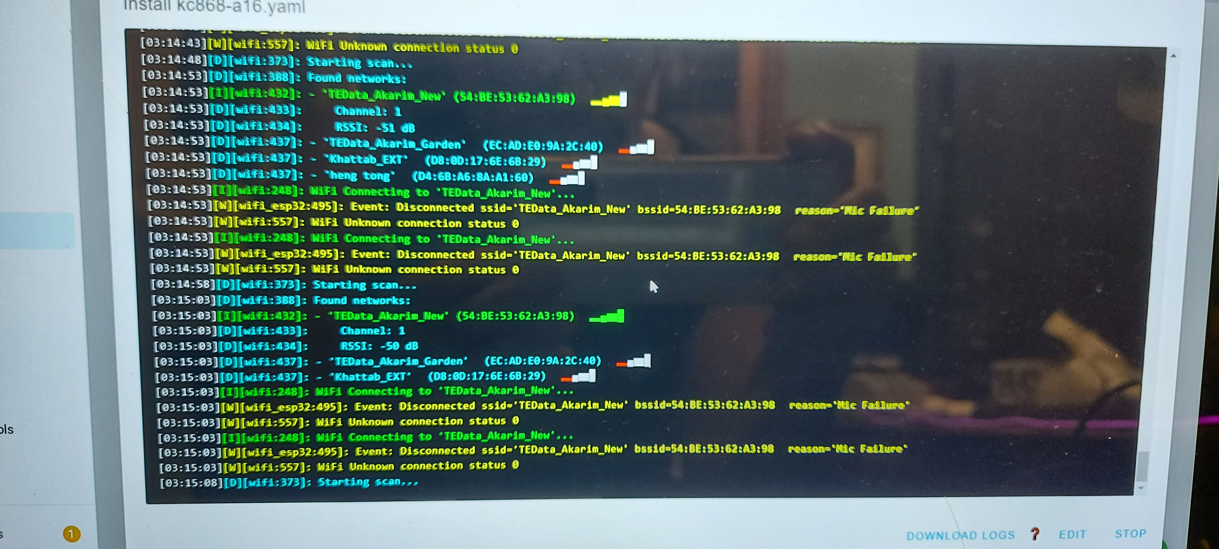

Regarding A16: and following lesson 21
I installef ESPHome using plug into computrr running ESPHome Dashboard ( for devices connected via usb to the server):
I connect usb-c in A16 ports to server usb port
Install kc868-a16.yaml
I recieved some errors
See attached download logs
.txt   logs_kc868-a16_upload.txt (Size: 18.58 KB / Downloads: 447)
.txt   logs_kc868-a16_upload (1).txt (Size: 9.67 KB / Downloads: 434)
#30
paste or upload your config file at here.
