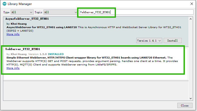

(09-05-2022, 03:12 AM)KinCony Support Wrote: [Arduino IDE demo source code for KC868-A8]--#11-Ethernet_Web server_code
if you want to use the Arduino source code ,you should install "WebServer_WT32_ETH01 "library first;
then you should find the file named  "WebServer_WT32_ETH01.hpp" and change the GPIO0 TO GPIO17;
