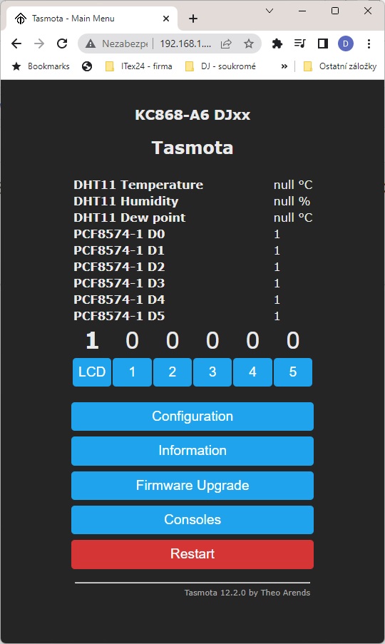

Yes, GPIO32 and GPIO33.
You can see:
https://www.itex24.cz/MainMenu.jpg
https://www.itex24.cz/Config.jpg
You can see:
You can see: https://www.itex24.cz/MainMenu.jpg https://www.itex24.cz/Config.jpg

Tasmota Settings~
In the Configuration -> Configure Module page assign: GPIOx to DS18x20 After a reboot the driver will display Temperature. Do you have reboot? here is details of tasmota work with DS18B20: https://tasmota.github.io/docs/DS18x20/#wiring
01-13-2023, 05:55 AM
Everything is OK. My fault. Sensor must be connected :-), if it isn't, the temperature visualization isn't visible.
