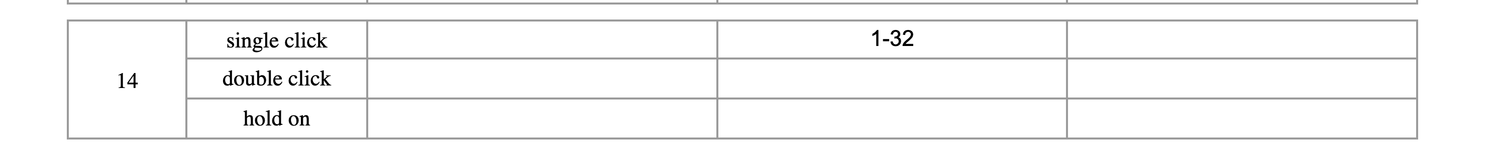

I have updated relay firmware to version 4.44, but unfortunately it still does not work with Keyboard.
Only way how it works is if I put 1-32. Any other combination (e.g 1-31 or 1-12) does not work. This feature is pretty critical for me as I have some master switched in building and they should work with multiple relay outputs. Another thing that I was not able to update relay firmware to version 4.45 or 4.46, after download and press run relay was not working, no LEDs were switched on and it was not possible to connect to web interface.

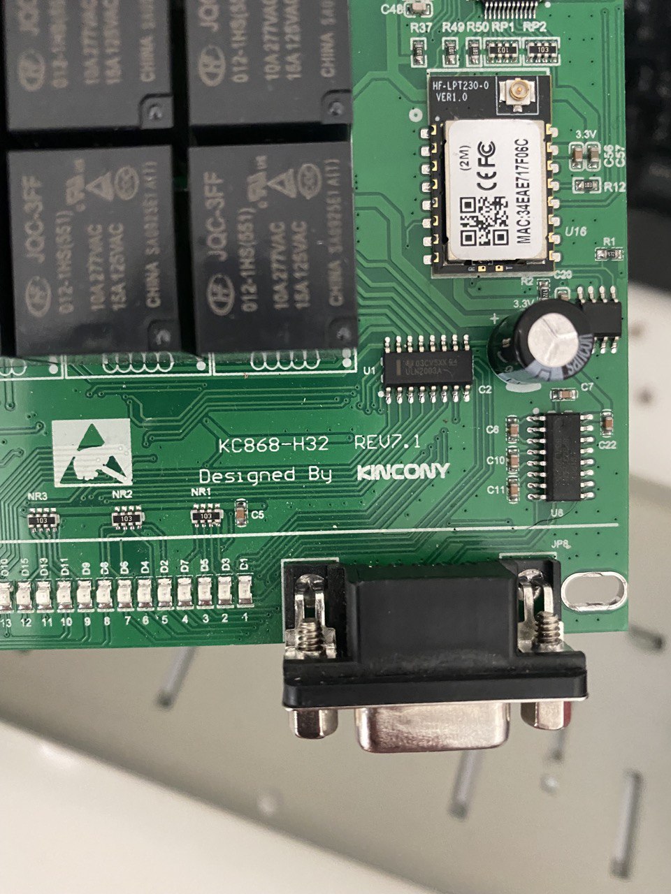

2. because begin with V4.45 , firmware size >128k, you need to update your CPU bootloader file, so that can support large new file. take a photo of your H32B pcb board, two side, i need to see your CPU chip model.
03-20-2023, 06:35 PM
H32B need update fimrware to use KC868-AK, H32B Pro is no problem. but you should have ST-Link for update STM32 CPU.
here is st-link cable: https://www.aliexpress.us/item/225183283..._shipto=US H32B will update firmware in furture when our development team have time. when it released, i will update to you.
