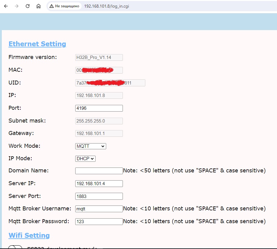

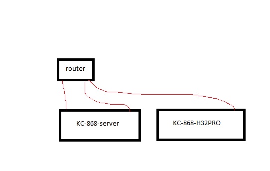

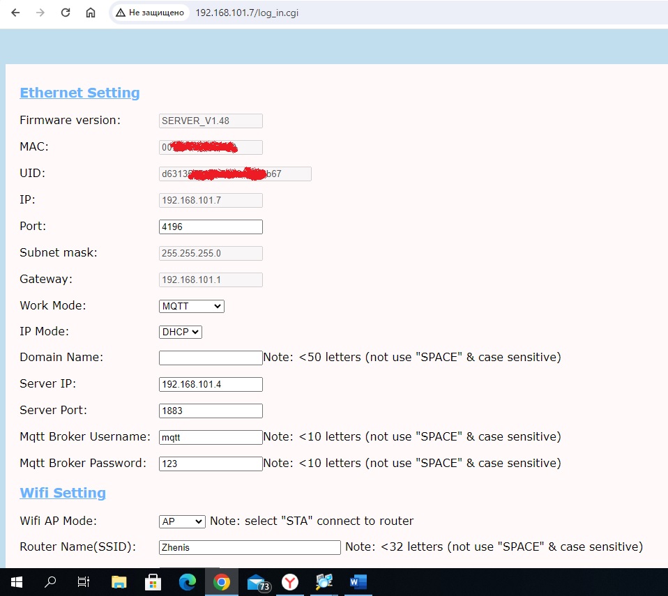

Good evening! Do you have a link on how to do it? I have to write the code KC868-H32B Pro in mqtt.yaml where are the codes from KC868-Server written? Or create a new yaml file for KC868-H32B Pro?

do your KC868-Server's IP address is 192.168.101.4?
please upload your yaml file at here. (not photo)
