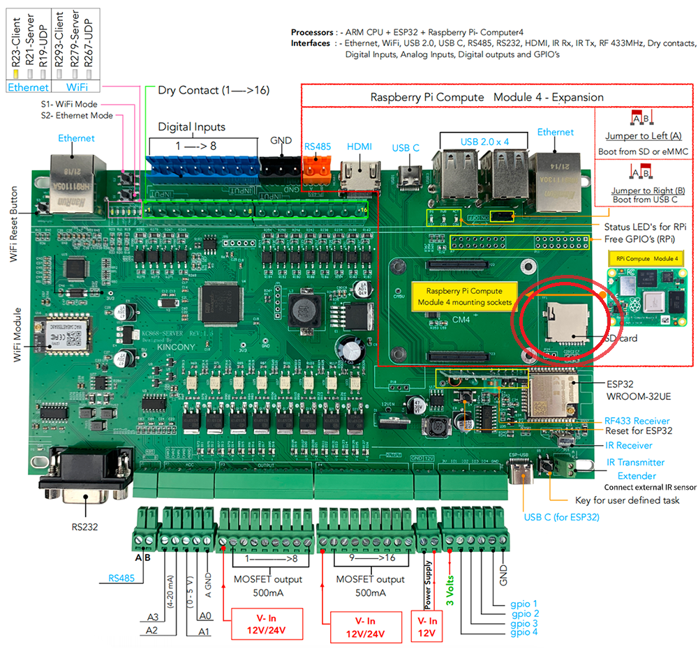

Available space is less than 1GB
how can i increase memory on LOCAL SERVER (RASPBERRY PI) – KC868-SERVER
can i used SD CARD ?

sure , if you use home assistsant, you can plugin USB disk. then move data to USB disk, home assistant have this function for move data.

Is it possible for me to use SD card ? as attach

no can't, it's eMMC CM4, only use by eMMC.
