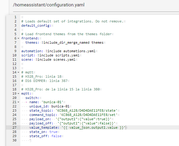

We used your configuration lines, it's seeing the device in HA, but it cannot control it. No feedback from device.
We used this lines:
mqtt:
  - name: 'bunica-01'
    unique_id: bunica-01
    state_topic: 'KC868_A128/D4D4DAE11FE8/state'
    command_topic: 'KC868_A128/D4D4DAE11FE8/set'
    state_on: true
    state_off: false
What is wrong here?
See also the screen captures.

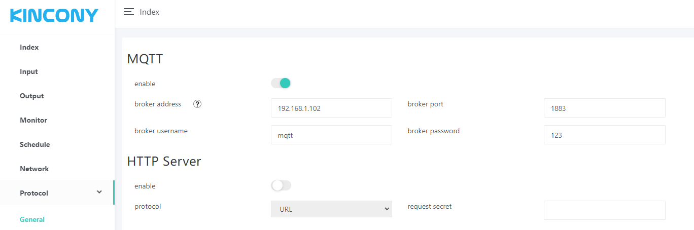

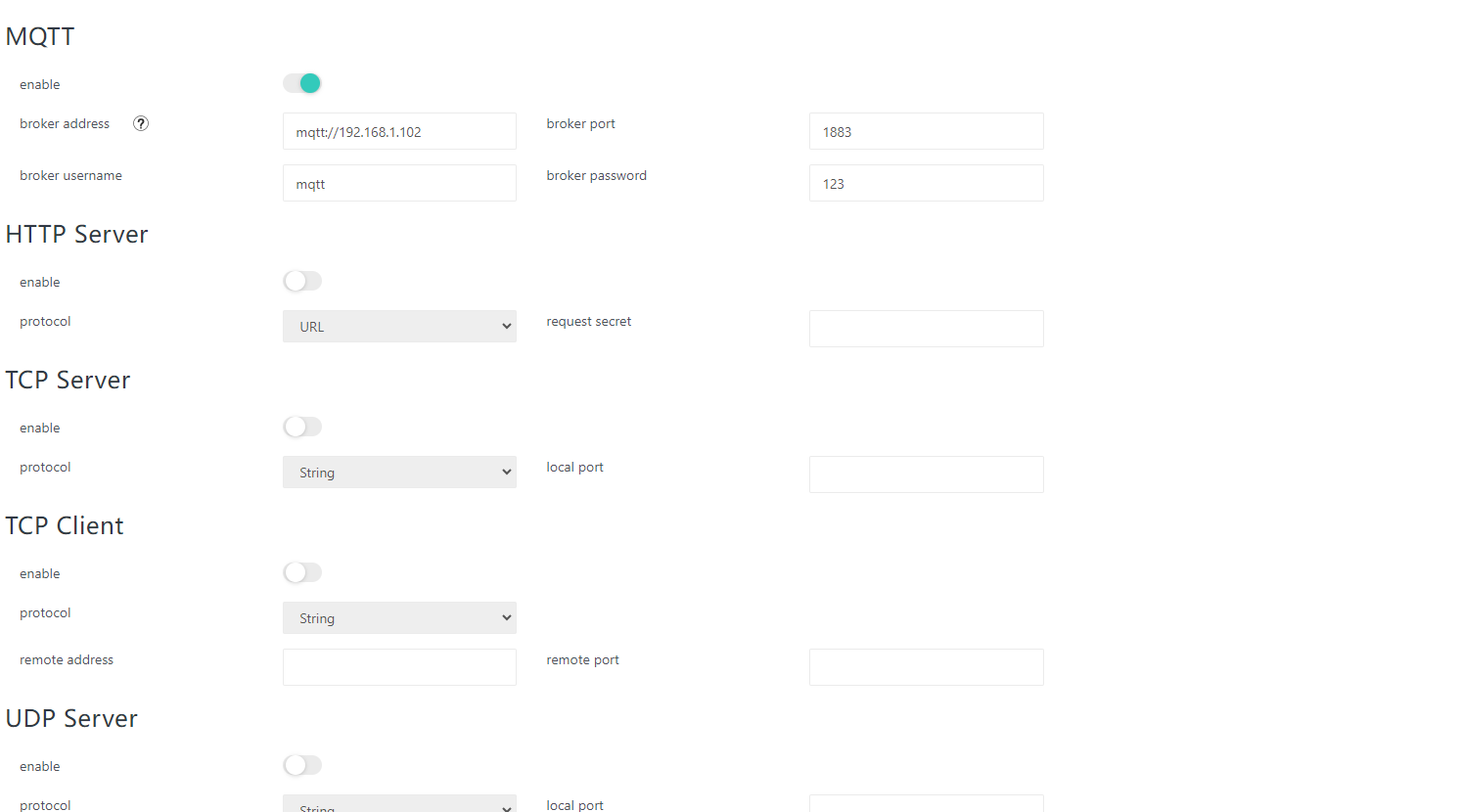

"broker address" should input mqtt://192.168.1.102 you not input "mqtt://"
in the YAML file to make this change or in the A128 board?
I tried this in the a128 card but with the same result. I see the button created in HA, but nothing happens when pressed
here.
post your yaml file at here.
it is posted above as a picture
and the file
.txt   Configuration.txt (Size: 1.06 KB / Downloads: 462)
state_topic: 'KC868_A128/D4D4DAE11FE8/state' wrong
command_topic: 'KC868_A128/D4D4DAE11FE8/set' wrong
should be
state_topic: 'KC868_A128/D4D4DAE11FE8/STATE'
command_topic: 'KC868_A128/D4D4DAE11FE8/SET'
"state" and "set", should be Uppercase。
Thank you. It is solved, it works.
