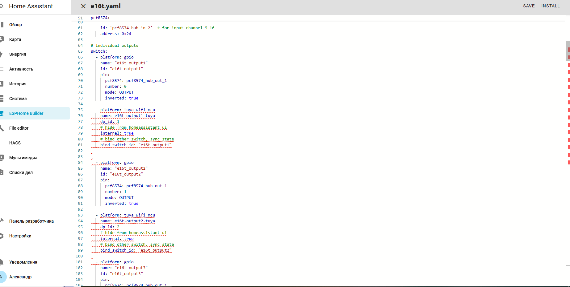

KC868-E16T added Tuya module yaml file for ESPHome
  platform: ESP32
  board: esp32dev
  platformio_options:
    board_build.extra_flags:
      # WIFI_CONTROL_SELF_MODE = 0
      # WIFI_CONTROL_SELF_MODE = 1
      - "-DWIFI_CONTROL_SELF_MODE=0"
external_components:
  - source:
      type: git
      ref: v1.1.0
uart:
  tx_pin: 33
  rx_pin: 14
  baud_rate: 9600
tuya_wifi_mcu:
  # tuya mcu product id
  product_id: tfj1dtlneyxp5uya
  uart_id: tuya_mcu_uart
  wifi_reset_pin: 5
  wifi_led_pin: 12
i2c:
  sda: 16
  scl: 15
  scan: true
# Example configuration entry
ethernet:
  type: LAN8720
  mdc_pin: GPIO23
  mdio_pin: GPIO18
  clk_mode: GPIO17_OUT
  phy_addr: 0
pcf8574:
    address: 0x21
    address: 0x25
    address: 0x22
    address: 0x24
# Individual outputs
  - platform: gpio
    pin:
      pcf8574: pcf8574_hub_out_1
      number: 0
      mode: OUTPUT
      inverted: true
  - platform: tuya_wifi_mcu
    dp_id: 1
    # hide from homeassistant ui
    internal: true
    bind_switch_id: "e16t_output1"
  - platform: gpio
    pin:
      number: 1
      mode: OUTPUT
      inverted: true
    dp_id: 2
    internal: true
    bind_switch_id: "e16t_output2"
  - platform: gpio
    pin:
      number: 2
      mode: OUTPUT
      inverted: true
    dp_id: 3
    internal: true
    bind_switch_id: "e16t_output3"
  - platform: gpio
    pin:
      number: 3
      mode: OUTPUT
      inverted: true
    dp_id: 4
    internal: true
    bind_switch_id: "e16t_output4"
  - platform: gpio
    pin:
      number: 4
      mode: OUTPUT
      inverted: true
    dp_id: 5
    internal: true
    bind_switch_id: "e16t_output5"
  - platform: gpio
    pin:
      number: 5
      mode: OUTPUT
      inverted: true
    dp_id: 6
    internal: true
    bind_switch_id: "e16t_output6"
  - platform: gpio
    pin:
      number: 6
      mode: OUTPUT
      inverted: true
    dp_id: 101
    internal: true
    bind_switch_id: "e16t_output7"
  - platform: gpio
    pin:
      number: 7
      mode: OUTPUT
      inverted: true
    dp_id: 102
    internal: true
    bind_switch_id: "e16t_output8"
  - platform: gpio
    pin:
      pcf8574: pcf8574_hub_out_2
      number: 0
      mode: OUTPUT
      inverted: true
    dp_id: 103
    internal: true
    bind_switch_id: "e16t_output9"
  - platform: gpio
    pin:
      number: 1
      mode: OUTPUT
      inverted: true
    dp_id: 104
    internal: true
    bind_switch_id: "e16t_output10"
  - platform: gpio
    pin:
      number: 2
      mode: OUTPUT
      inverted: true
    dp_id: 105
    internal: true
    bind_switch_id: "e16t_output11"
  - platform: gpio
    pin:
      number: 3
      mode: OUTPUT
      inverted: true
    dp_id: 106
    internal: true
    bind_switch_id: "e16t_output12"
  - platform: gpio
    pin:
      number: 4
      mode: OUTPUT
      inverted: true
    dp_id: 107
    internal: true
    bind_switch_id: "e16t_output13"
  - platform: gpio
    pin:
      number: 5
      mode: OUTPUT
      inverted: true
    dp_id: 108
    internal: true
    bind_switch_id: "e16t_output14"
  - platform: gpio
    pin:
      number: 6
      mode: OUTPUT
      inverted: true
    dp_id: 109
    internal: true
    bind_switch_id: "e16t_output15"
  - platform: gpio
    pin:
      number: 7
      mode: OUTPUT
      inverted: true
    dp_id: 110
    internal: true
    bind_switch_id: "e16t_output16"
binary_sensor:
  - platform: gpio
    pin:
      pcf8574: pcf8574_hub_in_1
      number: 0
      mode: INPUT
      inverted: true
    name: e16t DI01 Tuya
    dp_id: 111
    bind_binary_sensor_id: e16t_input1
    internal: true
  - platform: gpio
    pin:
      number: 1
      mode: INPUT
      inverted: true
    name: e16t DI02 Tuya
    dp_id: 112
    bind_binary_sensor_id: e16t_input2
    internal: true
  - platform: gpio
    pin:
      number: 2
      mode: INPUT
      inverted: true
    name: e16t DI03 Tuya
    dp_id: 113
    bind_binary_sensor_id: e16t_input3
    internal: true
  - platform: gpio
    pin:
      number: 3
      mode: INPUT
      inverted: true
    name: e16t DI04 Tuya
    dp_id: 114
    bind_binary_sensor_id: e16t_input4
    internal: true
  - platform: gpio
    pin:
      number: 4
      mode: INPUT
      inverted: true
    name: e16t DI05 Tuya
    dp_id: 115
    bind_binary_sensor_id: e16t_input5
    internal: true
  - platform: gpio
    pin:
      number: 5
      mode: INPUT
      inverted: true
    name: e16t DI06 Tuya
    dp_id: 116
    bind_binary_sensor_id: e16t_input6
    internal: true
  - platform: gpio
    pin:
      number: 6
      mode: INPUT
      inverted: true
    name: e16t DI07 Tuya
    dp_id: 117
    bind_binary_sensor_id: e16t_input7
    internal: true
  - platform: gpio
    pin:
      number: 7
      mode: INPUT
      inverted: true
    name: e16t DI08 Tuya
    dp_id: 118
    bind_binary_sensor_id: e16t_input8
    internal: true
  - platform: gpio
    pin:
      pcf8574: pcf8574_hub_in_2
      number: 0
      mode: INPUT
      inverted: true
    name: e16t DI09 Tuya
    dp_id: 119
    bind_binary_sensor_id: e16t_input9
    internal: true
  - platform: gpio
    pin:
      number: 1
      mode: INPUT
      inverted: true
    name: e16t DI10 Tuya
    dp_id: 120
    bind_binary_sensor_id: e16t_input10
    internal: true
  - platform: gpio
    pin:
      number: 2
      mode: INPUT
      inverted: true
    name: e16t DI11 Tuya
    dp_id: 121
    bind_binary_sensor_id: e16t_input11
    internal: true
  - platform: gpio
    pin:
      number: 3
      mode: INPUT
      inverted: true
    name: e16t DI12 Tuya
    dp_id: 122
    bind_binary_sensor_id: e16t_input12
    internal: true
  - platform: gpio
    pin:
      number: 4
      mode: INPUT
      inverted: true
    name: e16t DI13 Tuya
    dp_id: 123
    bind_binary_sensor_id: e16t_input13
    internal: true
  - platform: gpio
    pin:
      number: 5
      mode: INPUT
      inverted: true
    name: e16t DI14 Tuya
    dp_id: 124
    bind_binary_sensor_id: e16t_input14
    internal: true
  - platform: gpio
    pin:
      number: 6
      mode: INPUT
      inverted: true
    name: e16t DI15 Tuya
    dp_id: 125
    bind_binary_sensor_id: e16t_input15
    internal: true
  - platform: gpio
    pin:
      number: 7
      mode: INPUT
      inverted: true
    name: e16t DI16 Tuya
    dp_id: 126
    bind_binary_sensor_id: e16t_input16
    internal: true

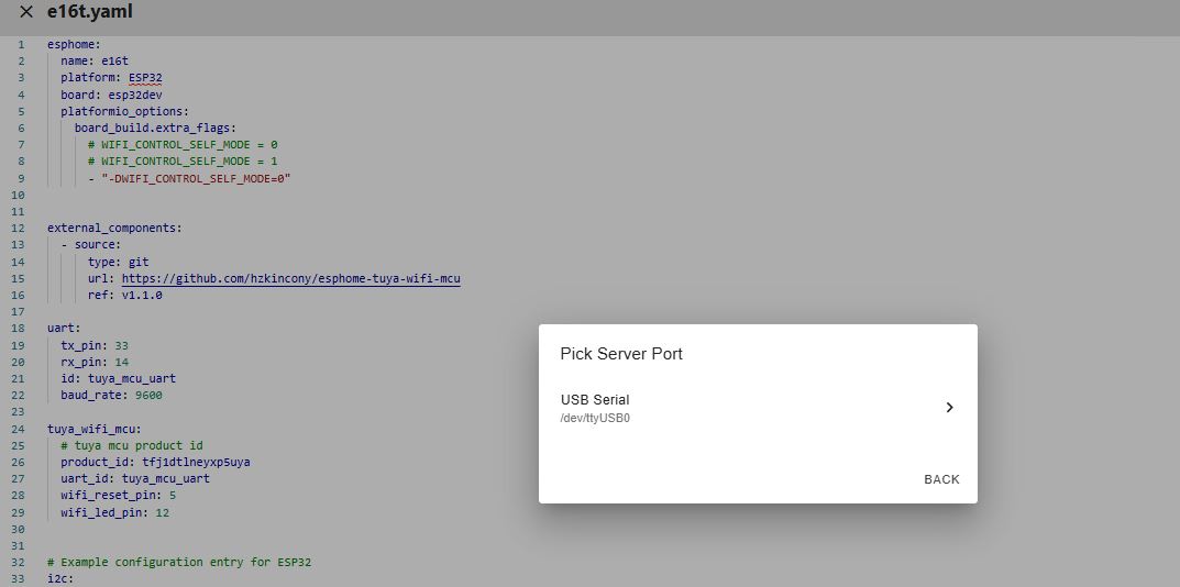

I tried to upload this file to my e16t via Home Assist, but I get an error at the very beginning.
Please help.
because ESPHome 2025.2 have update. use this new yaml file:
  platformio_options:
esp32:
  board: esp32dev
  framework:

Thank You. Everything OK!
if you want INPUT toggle OUTPUT, you can use this new yaml: https://www.kincony.com/forum/showthread.php?tid=7827
I did it as described above. an error occurs when trying to download the configuration file. the logs are attached
.txt   logs_e16t_run.txt (Size: 20.39 KB / Downloads: 325)
updated esphome yaml:

      number: 7
      mode: OUTPUT
      inverted: true
    dp_id: 102
    internal: true
  - platform: gpio
    pin:
      number: 0
      mode: OUTPUT
      inverted: true
    dp_id: 103
    internal: true
  - platform: gpio
    pin:
      number: 1
      mode: OUTPUT
      inverted: true
    dp_id: 104
    internal: true
  - platform: gpio
    pin:
      number: 2
      mode: OUTPUT
      inverted: true
    dp_id: 105
    internal: true
  - platform: gpio
    pin:
      number: 3
      mode: OUTPUT
      inverted: true
    dp_id: 106
    internal: true
  - platform: gpio
    pin:
      number: 4
      mode: OUTPUT
      inverted: true
    dp_id: 107
    internal: true
  - platform: gpio
    pin:
      number: 5
      mode: OUTPUT
      inverted: true
    dp_id: 108
    internal: true
  - platform: gpio
    pin:
      number: 6
      mode: OUTPUT
      inverted: true
    dp_id: 109
    internal: true
  - platform: gpio
    pin:
      number: 7
      mode: OUTPUT
      inverted: true
    dp_id: 110
    internal: true
binary_sensor:
  - platform: gpio
    pin:
      number: 0
      mode: INPUT
      inverted: true
    dp_id: 111
    internal: true
  - platform: gpio
    pin:
      number: 1
      mode: INPUT
      inverted: true
    dp_id: 112
    internal: true
  - platform: gpio
    pin:
      number: 2
      mode: INPUT
      inverted: true
    dp_id: 113
    internal: true
  - platform: gpio
    pin:
      number: 3
      mode: INPUT
      inverted: true
    dp_id: 114
    internal: true
  - platform: gpio
    pin:
      number: 4
      mode: INPUT
      inverted: true
    dp_id: 115
    internal: true
  - platform: gpio
    pin:
      number: 5
      mode: INPUT
      inverted: true
    dp_id: 116
    internal: true
  - platform: gpio
    pin:
      number: 6
      mode: INPUT
      inverted: true
    dp_id: 117
    internal: true
  - platform: gpio
    pin:
      number: 7
      mode: INPUT
      inverted: true
    dp_id: 118
    internal: true
  - platform: gpio
    pin:
      number: 0
      mode: INPUT
      inverted: true
    dp_id: 119
    internal: true
  - platform: gpio
    pin:
      number: 1
      mode: INPUT
      inverted: true
    dp_id: 120
    internal: true
  - platform: gpio
    pin:
      number: 2
      mode: INPUT
      inverted: true
    dp_id: 121
    internal: true
  - platform: gpio
    pin:
      number: 3
      mode: INPUT
      inverted: true
    dp_id: 122
    internal: true
  - platform: gpio
    pin:
      number: 4
      mode: INPUT
      inverted: true
    dp_id: 123
    internal: true
  - platform: gpio
    pin:
      number: 5
      mode: INPUT
      inverted: true
    dp_id: 124
    internal: true
  - platform: gpio
    pin:
      number: 6
      mode: INPUT
      inverted: true
    dp_id: 125
    internal: true
  - platform: gpio
    pin:
      number: 7
      mode: INPUT
      inverted: true
    dp_id: 126
    internal: true
# Enable Home Assistant API
yaml file download:
.txt   E16T-HA-Tuya.txt (Size: 11.96 KB / Downloads: 301)
Thank you. everything worked
ok, good.
