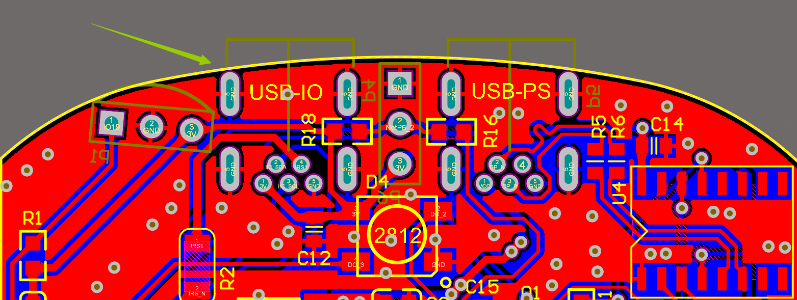

if you want use DS18B20, see this topic, our customer have already worked with new ESPHome:
https://www.kincony.com/forum/showthread.php?tid=5939

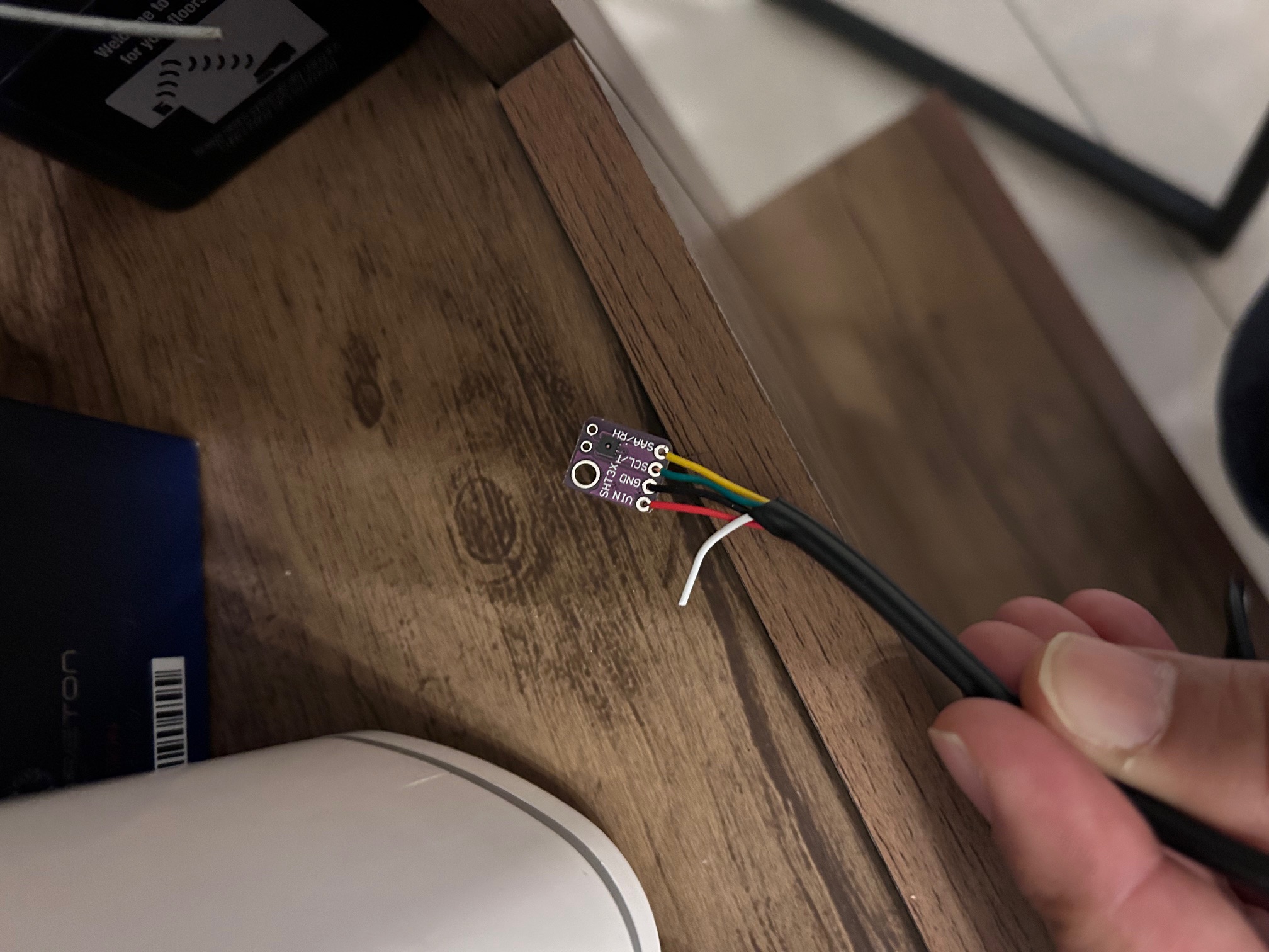

for the internal temperature its shown but external Nop, it shows 0C temp and 0 Humidity
i think it's i2c extend usb cable pins define problem.  before i am using 4-wires USB mini cable in YouTube video. here is photo:
But now you are using 5-wires. Here is our PCB usb pin define.can you use a multi meter to check whether the vcc,gnd,sda,scl pin is connect correctly. also make sure you have connected with correct USB port of Uair box.
