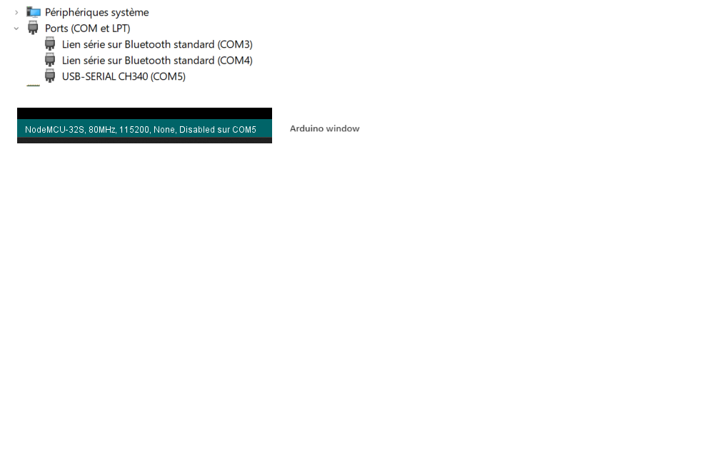

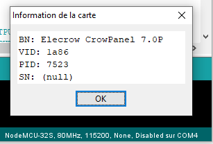

kc868_A8: NodeMCU-32s, 80Mhz, 115200. None. Disabled sur COM4.
Hi
please help, i didnt connect the KC868-A8 bord with arduino app.
When read information from board i receive the picture attached

Hi; the problem is connection between comuputer and KC868-A8 (disabled on com4) but it's working with arduino uno.
do you have installed USB driver, here is link: https://www.kincony.com/download/CH341SER.zip
(07-14-2024, 12:31 AM)admin Wrote: do you have installed USB driver, here is link: https://www.kincony.com/download/CH341SER.zip
Yes, usb driver installed and port selected in arduino app.

Port driver is installed. I think that the arduino app  didn't know the panel as NodeMCU 32s.
if you can download firmware to A8 board, that means PCB hardware is OK.
you can try to use another computer have a test.
(07-15-2024, 12:36 AM)admin Wrote: if you can download firmware to A8 board, that means PCB hardware is OK.
Hi, now it’s working when I re installed the arduino app. Thanks for your support.
