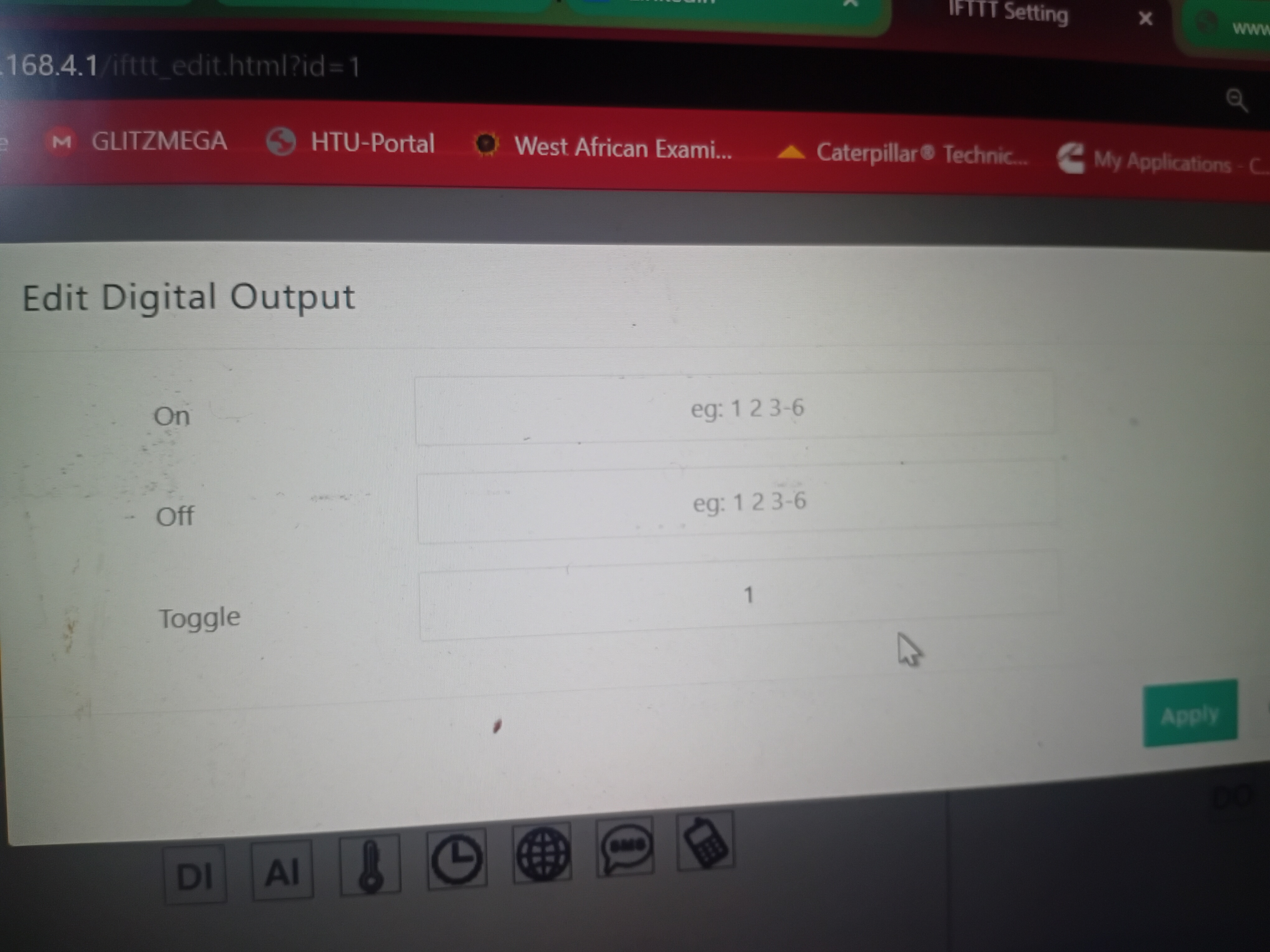

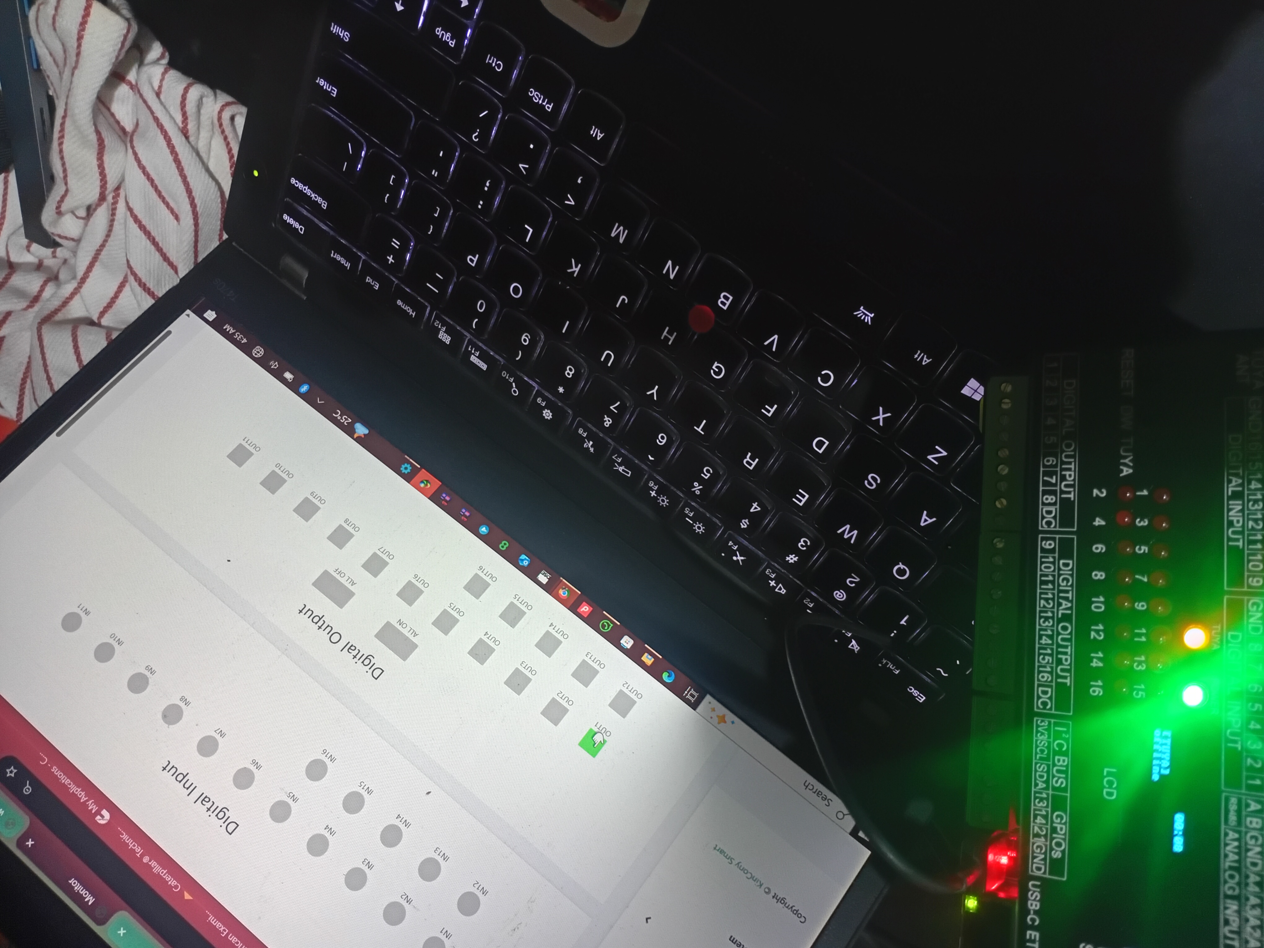

i got the software KCS_B16M_V3.4.0. install but it is not operating the same way as when i first receive, because when i load the yaml code the firmware is easing. also the browser the input is extremely limited
on the browser page the input is extremely limited
Do you means only 9 INPUT? not 16 INPUT?

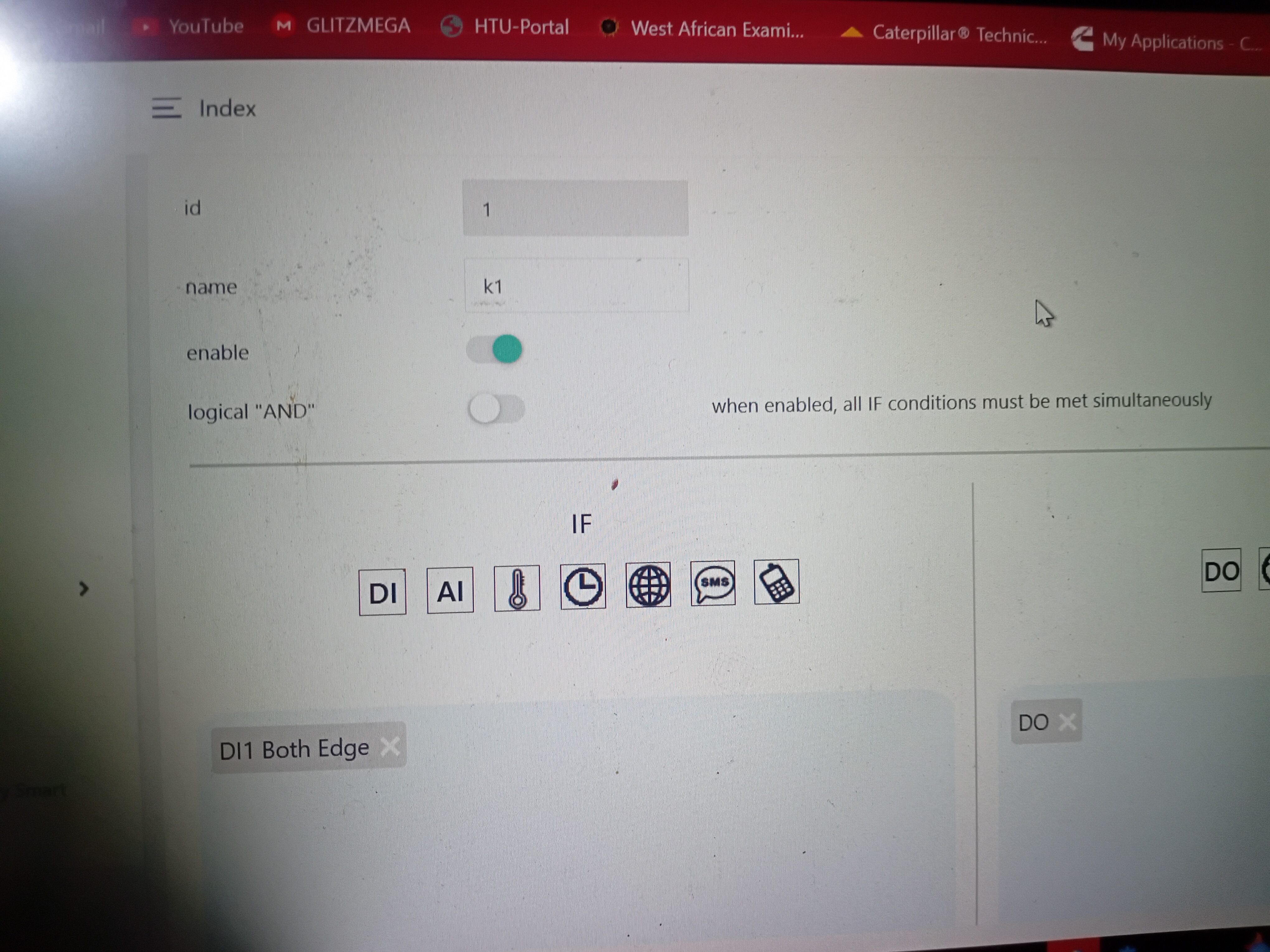

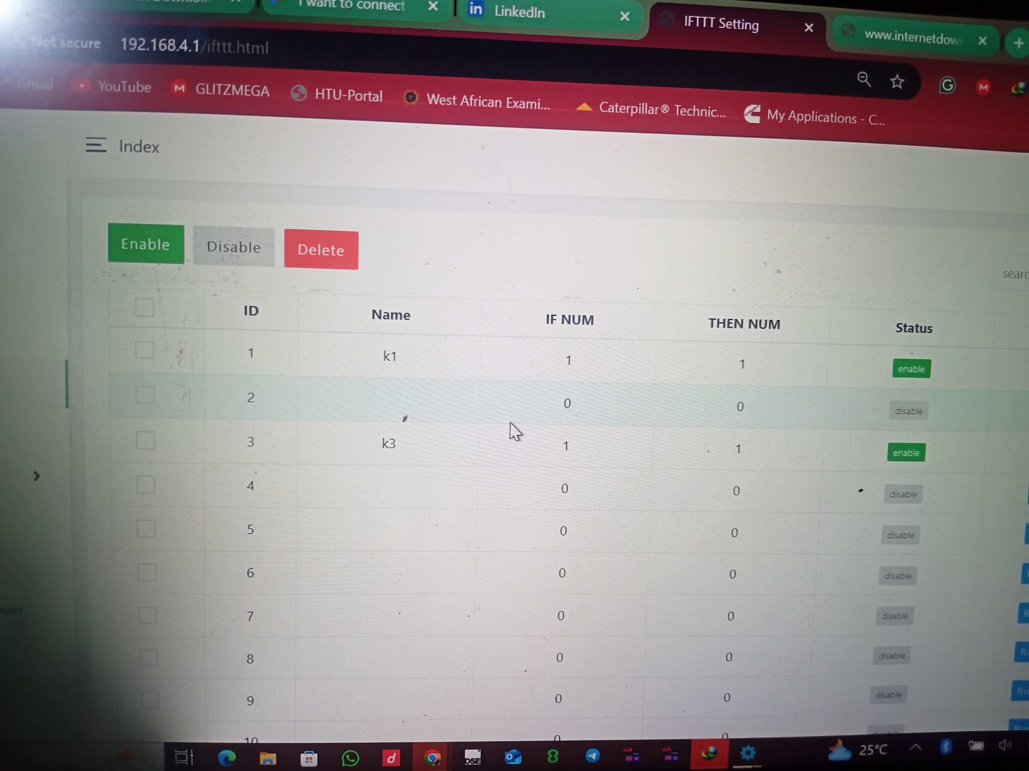

no please the input i cannot toggle , use leading edge  nor the other switch positions
you need config INPUT toggle OUTPUT at IFTTT webpage. please see KCS v3 online guide firstly.

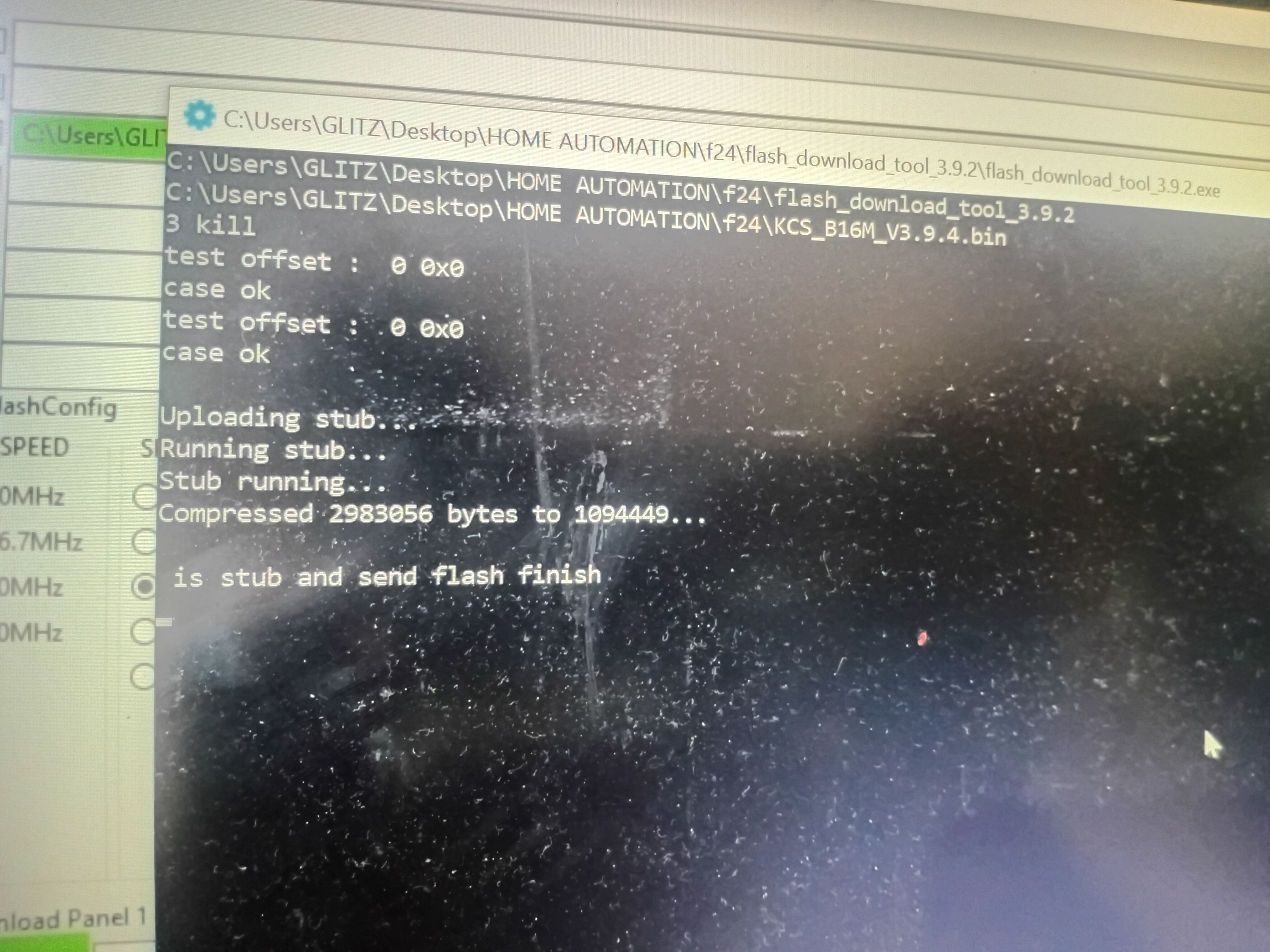

I have downloaded the firmware on B16m but the out led light of the digital out is not coming
