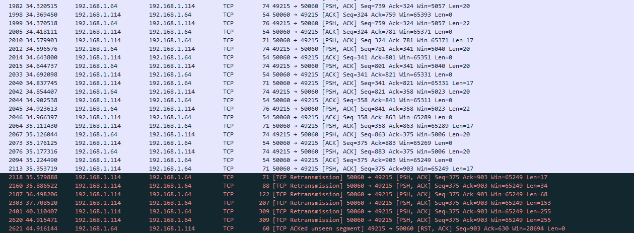

I configured a KC868-A8 as a TCP Server and I am having the following problem
if I send the command to turn ON and OFF a relay for 8 or 9 times (some times only 3 or 4 times) it works but after that the server does not respond anymore
firmware is v2.2.13
power supply is original
I also tried to check the communication with wireshark and when the communication stops wireshark shows as in the attached figure
kc868-A8 ip is 192.168.1.64
suggestions?
thank you in advance

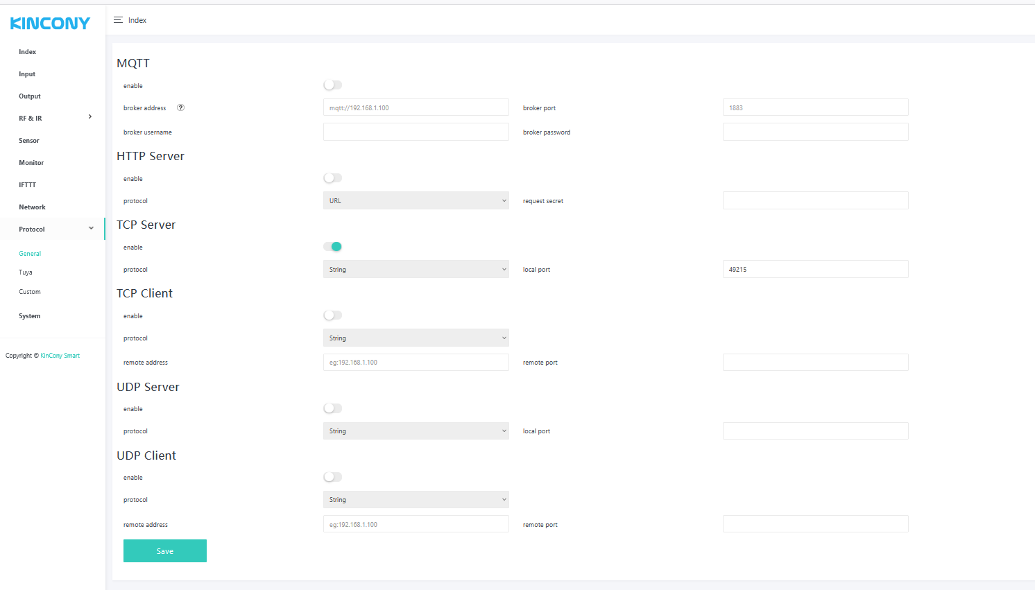

do you have disable others protocol, only enabled "TCP Server" protocol?
(06-21-2025, 02:16 AM)admin Wrote: do you have disable others protocol, only enabled "TCP Server" protocol?
yes, correct

KC868-A8 controls a light, sometimes it works 2 or 3 time, after that the servers stops to reply to the commands and my client doesn't know which is the status of relay
I restart the client and it works for 2 or 3 times again

I make a small programm that turn on and off relay 7 every 1 sec
In the back you can see the web page of the device, 2 thinks:
1 I revecive the sent message in maybe all reply (just first reply not include the sent message)
2 Client is disconnected after problem
For connection I use synapse library
thank you
