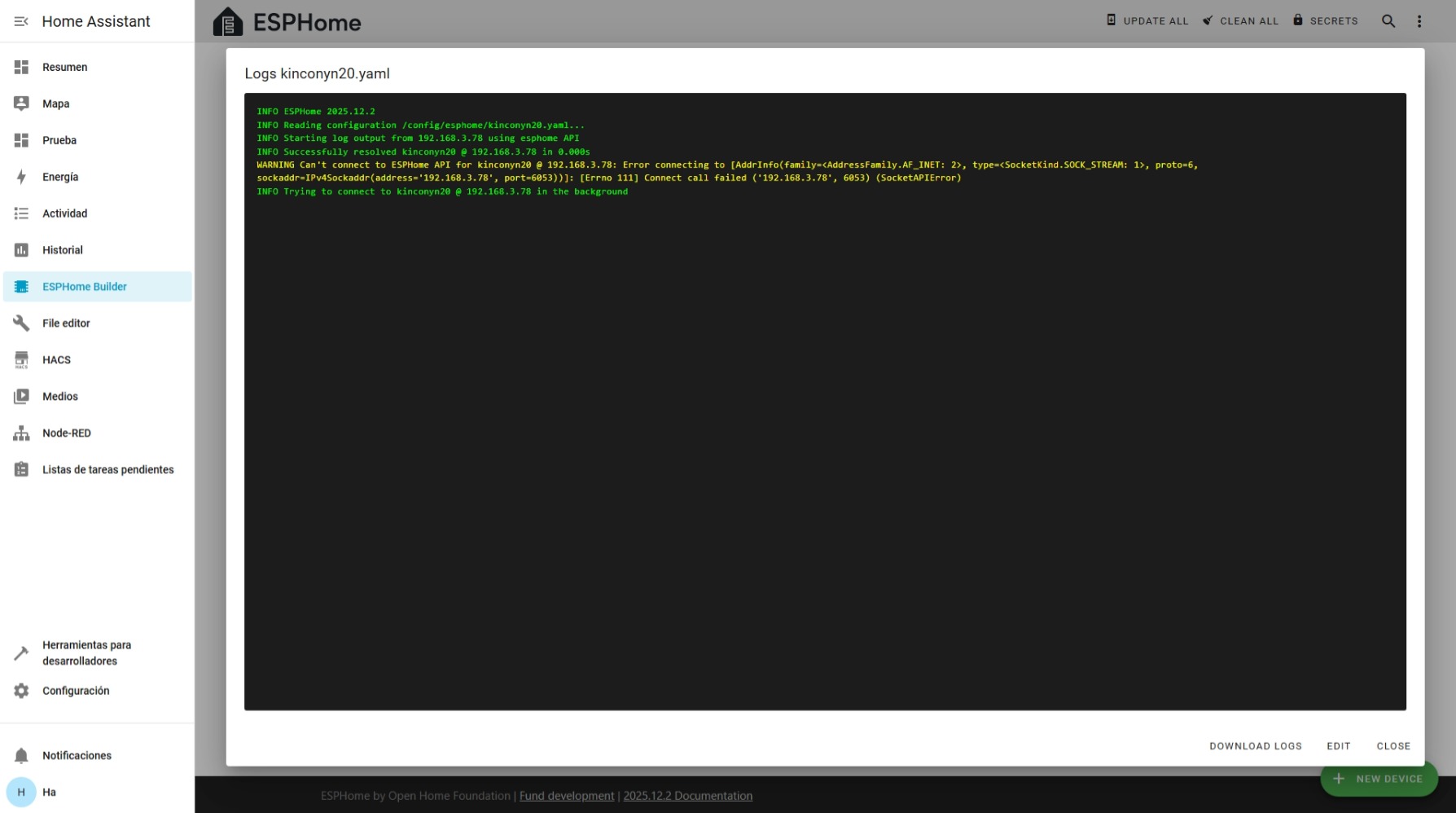

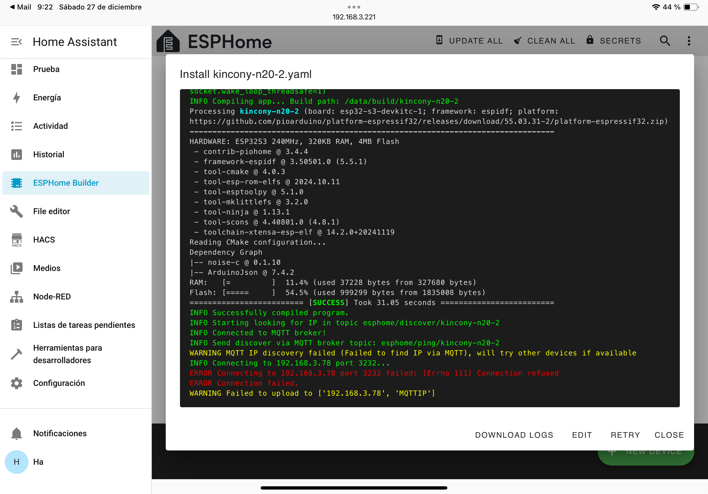

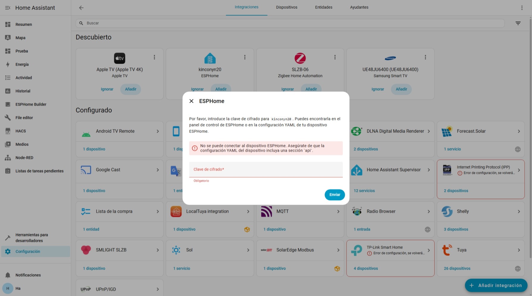

I followed the steps and I still can't connect it to Home Assistant. It appears in ESPHomeBuilder but with an error.

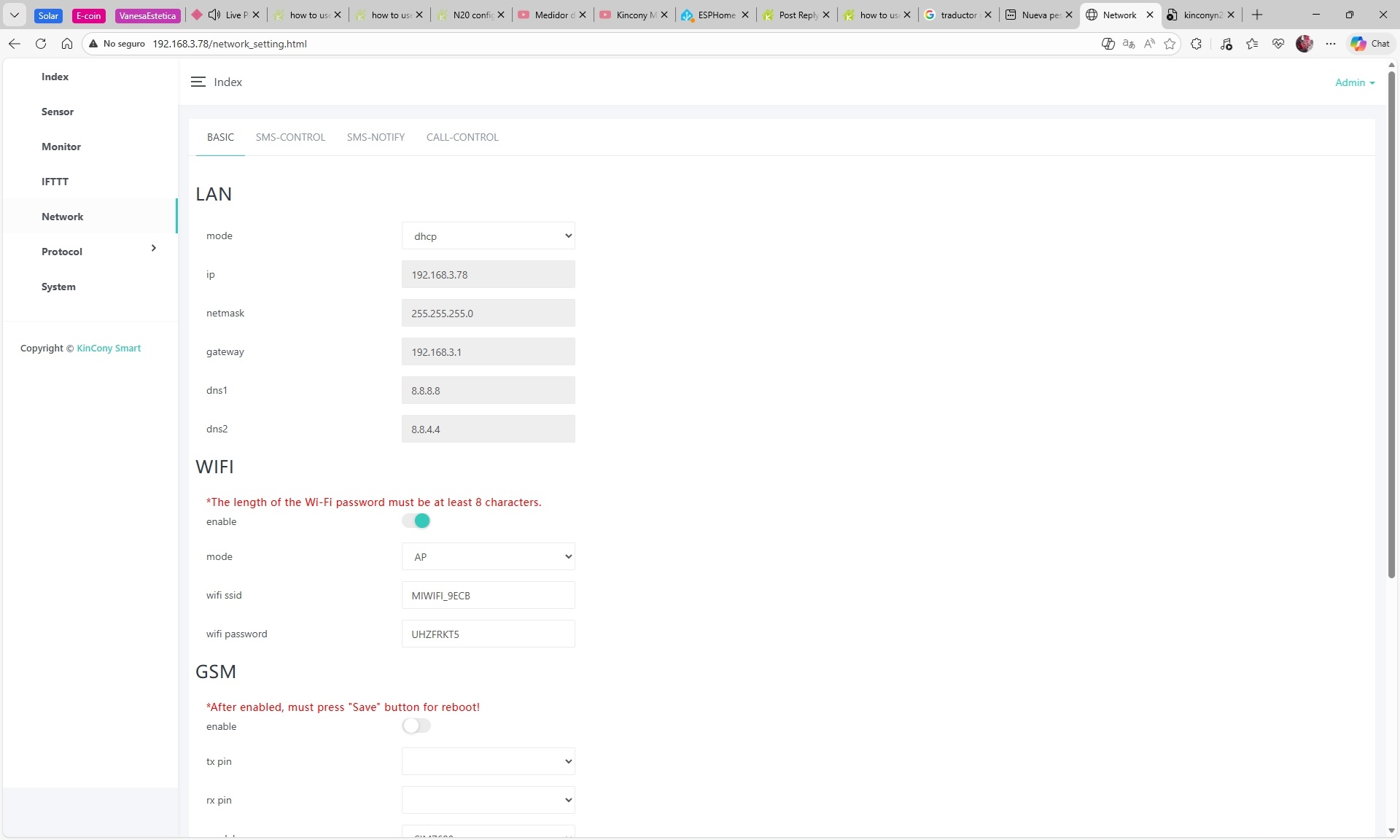

I can access the device via web 192.168.3.78 (dhcp) but never via kinconyn20.local. Why doesn't it work?

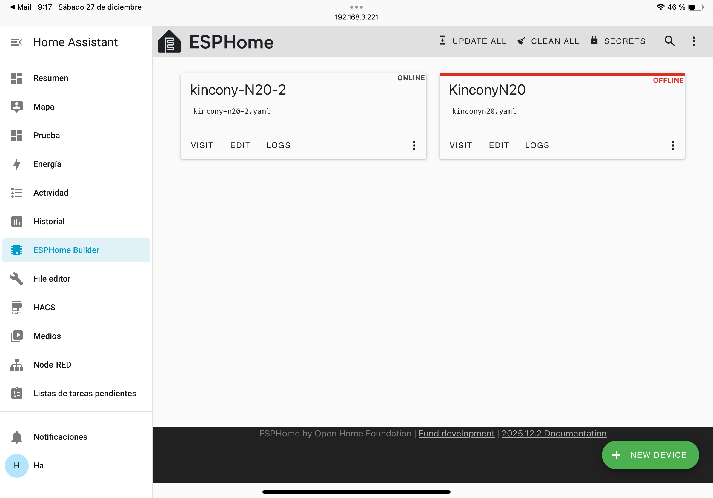

Attached photo when kincony is in 192.168.3.78 and work kincony
Attached photo when in homeAssistant is online
Attached photo showing that, despite being online, it cannot connect to 192.168.78

After trying many methods, I finally got it working, though not without some difficulty. I managed to connect it via USB to the Home Assistant server. No other method worked, and I tried many. Connecting via IP gave me a lot of problems and headaches; Home Assistant wouldn't recognize the IP address, even though the device itself was working.
Now I'm struggling with MQTT. I can no longer access the device via IP. I can get the sensor data via IP, but not the configuration. I imagine this is related to Home Assistant.
