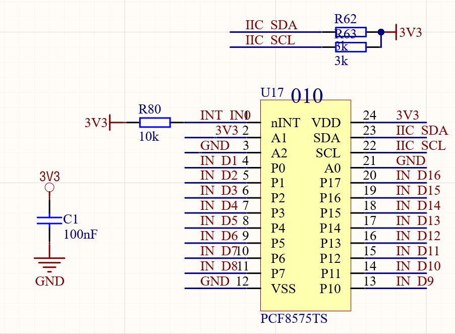

Is the schematic diagram available for the B8M?
I am specifically looking to see if the INT pin 1 of the PCF8575 is connected to anything.
I have used the PCF8575 IC in other applications, and prefer to use the interrupt when possible.
Thank You

PCF8575 INT pin not used. if you want to use , you can solder it to ESP32 free pin.

So no schematic?
It looks like the pin 1 of the PCF8575 has a trace going to R80.
The other side of R80 looks to be tied to 3.3v as a pull-up.
Just checking.
Also, to find a convenient free IO pin, I noticed in the pin document page that it shows GPIO5 in two places:
SD Card:
SPI-MOSI:GPIO10
SPI-SCK:GPIO11
SPI-MISO:GPIO12
SPI-CS:GPIO9
SPI-CD:GPIO5
RF433M sender:GPIO4
RF433M receiver:GPIO5
If this board does not use RF433M, should that mean that GPIO4 is really free?
Edit- looking at the ESP32 data sheet, it looks like pin 4 might not be a good choice anyway (strapping pin), looks like GPIO6 would be good.
