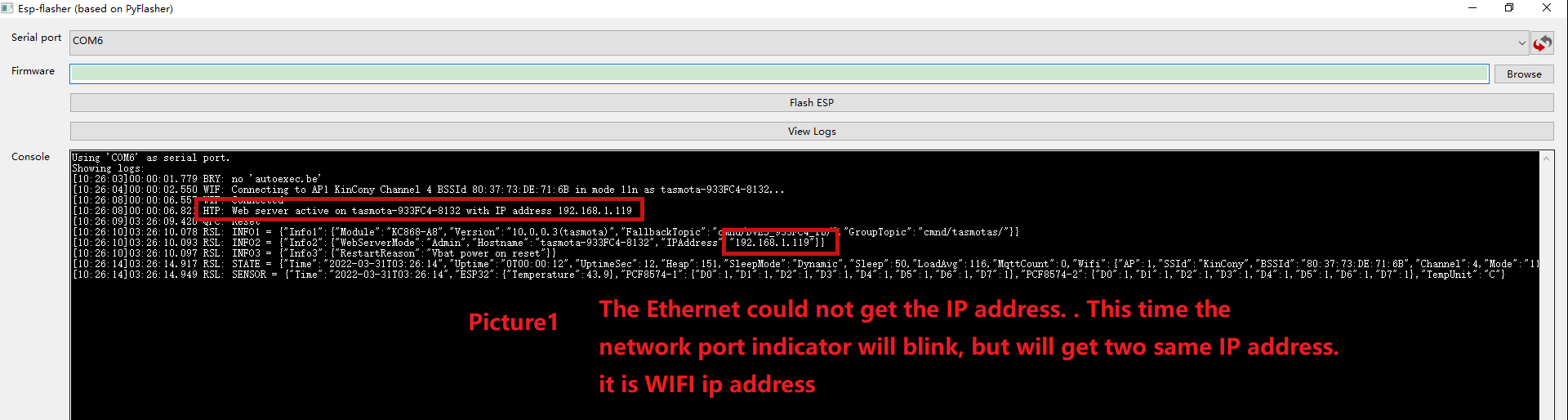

It is possible that the Ethernet cannot obtain the IP address. I tried to connect the network cable to the switch, but it did not connect to the router. This time the phenomenon is the same as you, the network port indicator will blink, but will get two same IP address.
like picture 1

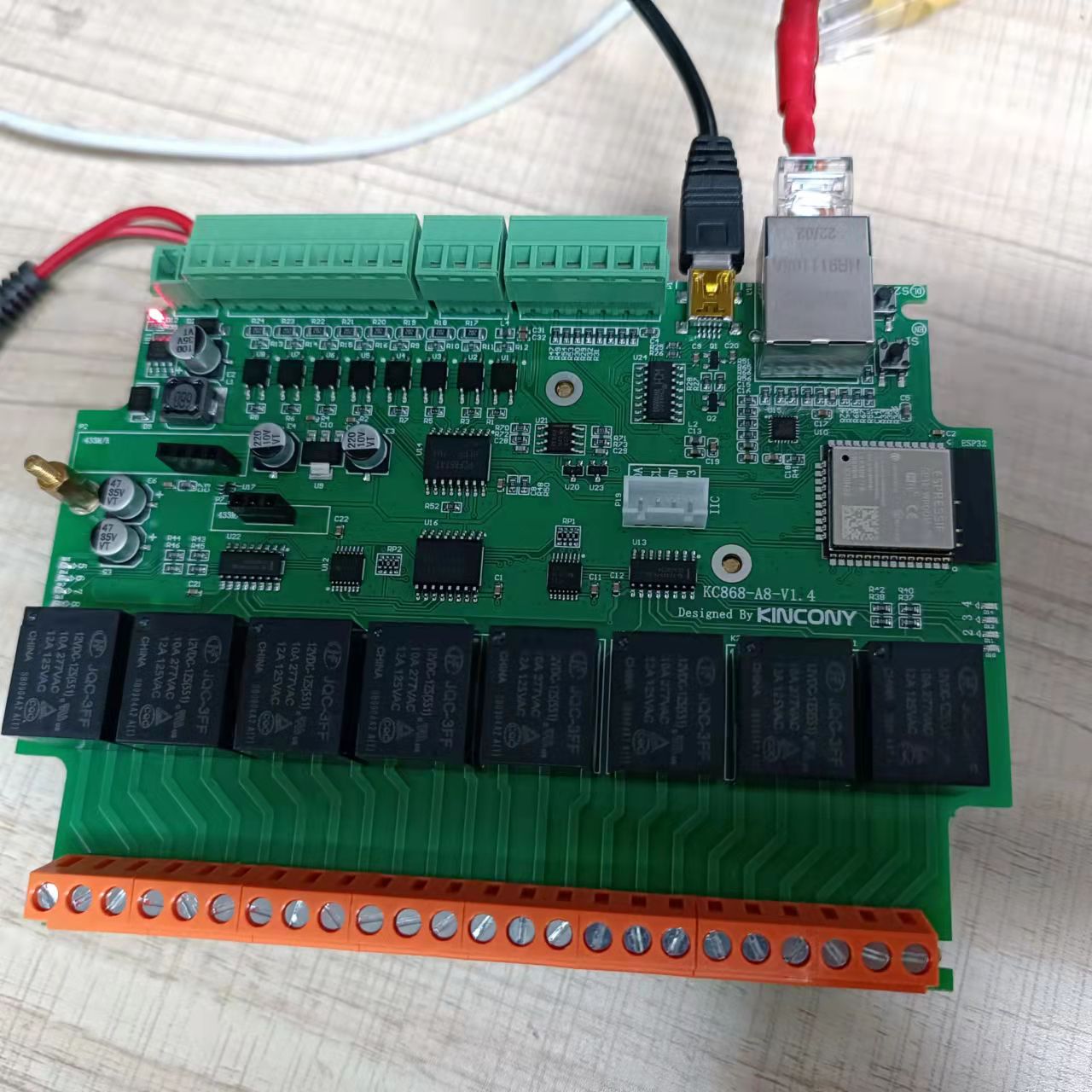

The following is a network cable connected to the router, you can correctly obtain Ethernet IP and WIFI IP
attachment=810][
attachment=811]
