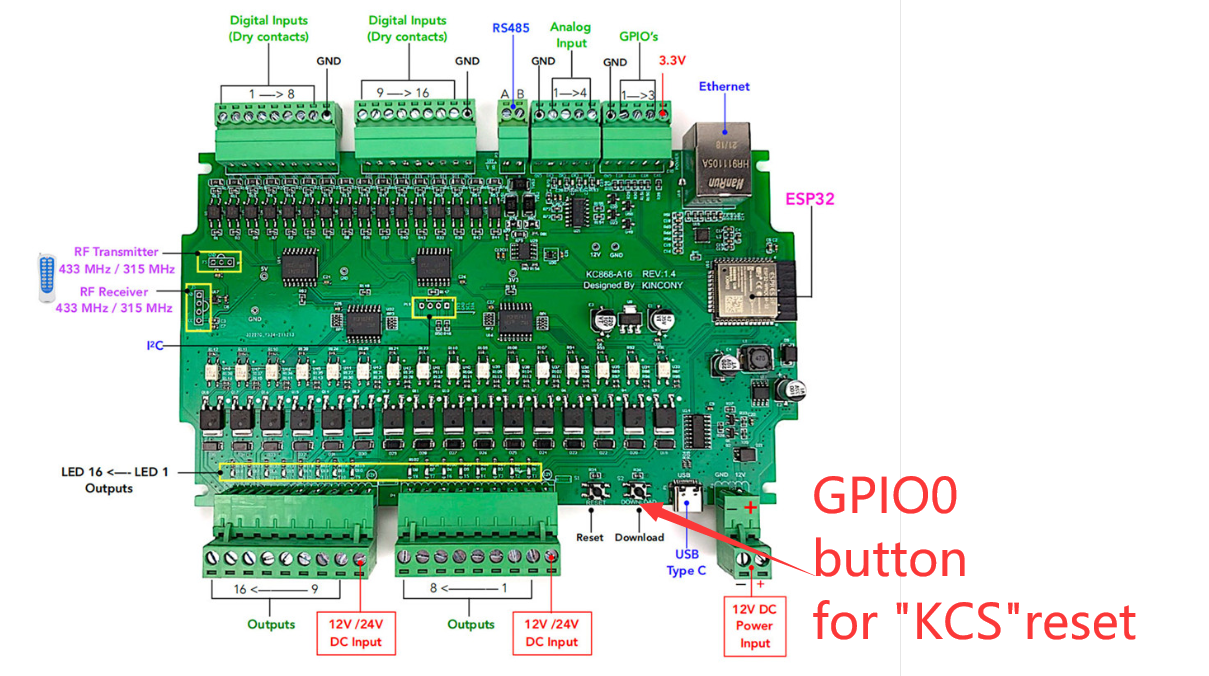

I can no longer find and access my KC868-A16 board by WIFI or LAN.
How to do a factory reset?

Hi.
I can no longer find and access my KC868-A16 board by WIFI or LAN. How to do a factory reset?
03-28-2023, 08:40 AM
if you have download the "KCS" firmware. you can HOLD ON the GPIO0 button > 10 seconds. then board will be enable ethernet to DHCP. you can connect with your ethernet cable. use kincony scan deivce tool to find out the IP address of board.
scan device tool download: https://www.kincony.com/download/UDP_SCAN_LIST.zip
03-28-2023, 10:08 AM
Where is the GPIO0 button, is that the RESET?
03-28-2023, 10:32 AM
03-28-2023, 10:45 AM
Thank you very much.
Working just fine, I get access again from web browser!
