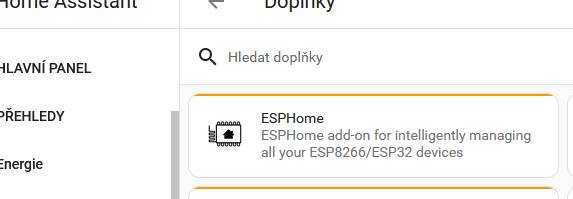

The ESPHome addon has long been installed in HomeAssistant.
Thanks for the link to the contents of the YAML file for A16.
But I still don't know where this file should be saved? How to integrate?
...so far I haven't found a procedure that I can replicate on my H.A..
