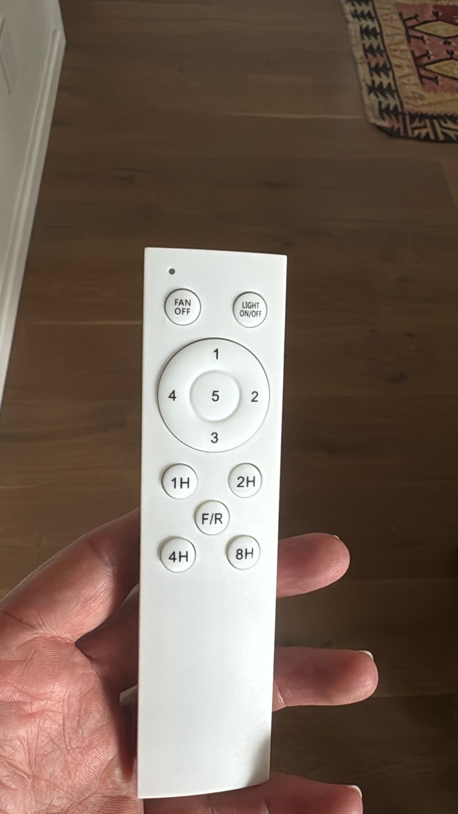

Pls look at these remote and frequency, I am not able to learn this RF remote
any advice pls

do you have learned RF signal successfully in KCS webpage?
(11-08-2025, 12:49 AM)admin Wrote: do you have learned RF signal successfully in KCS webpage?
I have 3 remotes
A - RF for TV LIFT (successfully learn in KCS web)
B - RF for Blinds (successfully learn KCS web)
C - Fan Remote (not successful in KCS, picture of remote above, and the frequency, on another project it was successful learn with Bond Bridge)
*The fan is DC brushless motor so can not do AC control
these A and B whether have auto created "button" on KCS monitor webpage?
yes i do have the buttons in KCS
