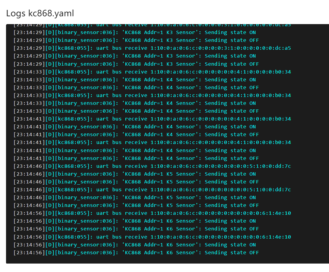

I want to send feedback from Home Assistant ESPHome to KC868-HA indicator outputs (on/off). KC868-A64's relay state feedback to KC868-HA or other any relay state feedback to KC868-HA? sorry, i am not sure your means.

1. I want six entities to Home Assistant (with ESPHome) wich can turn on/off KC868-HA D1-D6-outputs --->This i think can do.
2. And six entities that will show input K1-K6 state ---> in home asisstant can't show K1-K6 state for "ON/OFF", only can get a message from key is pressed, i don't know do you understand me?

when i have free time, i try to test it with ESPHome.
