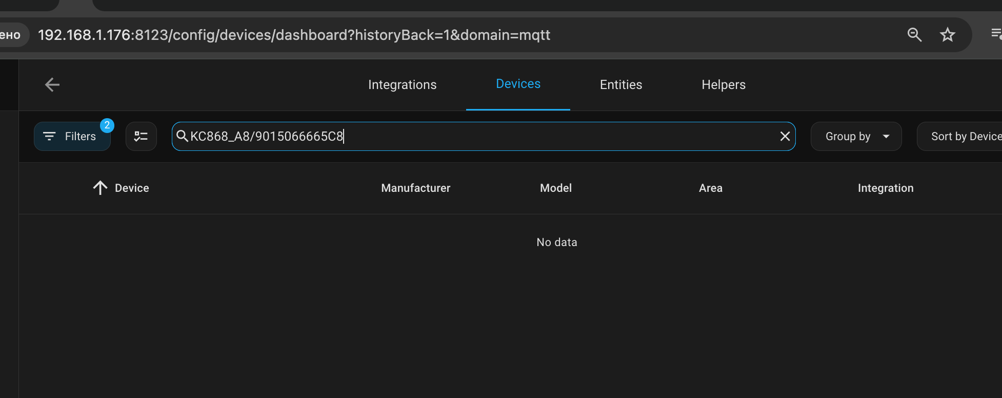

I installed a new KCS firmware and want to connect via mqtt . I registered all the settings for mqtt and see the device in the mqtt explorer but I don't see it in mqtt Home Assistants . Check attachment please
