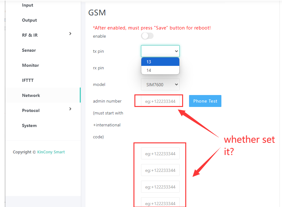

Do you have set the admin phone number at here? Since the incoming number is not set as the administrator, the call will be rejected.
(05-19-2025, 11:37 PM)admin Wrote: Do you have set the admin phone number at here? Since the incoming number is not set as the administrator, the call will be rejected.
