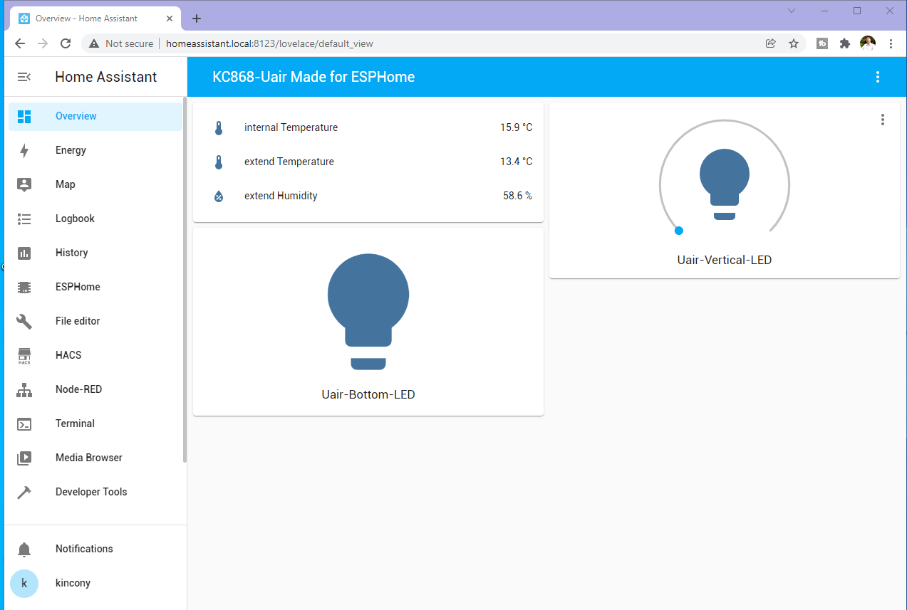

1. To enable the USB 2.0 ports on the raspberry pi 4 Compute Module 4, you need to edit the boot config file (/boot/config.txt) and add:
dtoverlay=dwc2,dr_mode=host
2. enable home assistant “Advanced Mode”
3. install ESPHome in Add-ons
4. config KC868-Uair
KC868-Uair document:
KC868-Uair ESP32 I/O pin define: https://www.kincony.com/forum/showthread.php?tid=1438
ESPHome configure for KC868-Uair:
platform: ESP32
board: esp32dev
# Enable Home Assistant API
ota:
password: “978e66f878ed5041b830cfb427393c79”
wifi:
ssid: “KinCony” # your wifi router ssid
password: “12345678” # your wifi password
ap:
ssid: “Kc868-Uair Fallback Hotspot”
password: “FbTxCLlbDvbO”
captive_portal:
# follow configure use for DS18B20 temperature sensor, SHT30 temperature and humidity sensor. WS2812B RGB LEDs.
i2c:
sda: 4
scl: 16
scan: true
# Example configuration entry
dallas:
– pin: GPIO27
update_interval: 15s
# Individual sensors
sensor:
– platform: dallas
address: 0xC000000004D81528 # your DS18B20 address
name: “internal Temperature”
– platform: sht3xd
temperature:
name: “extend Temperature”
humidity:
name: “extend Humidity”
address: 0x44
light:
– platform: fastled_clockless
chipset: WS2812B
pin: GPIO32 # Pin Define connected with LED strip
num_leds: 4 #LEDs number
rgb_order: GRB
effects:
– addressable_rainbow: ##defined 7 effects styles
– addressable_color_wipe:
– addressable_scan:
– addressable_twinkle:
– addressable_random_twinkle:
– addressable_fireworks:
– addressable_flicker:
chipset: WS2812B
pin: GPIO33 # Pin Define connected with LED strip
num_leds: 1 #LEDs number
rgb_order: RGB
effects:
– addressable_scan:
Made_for_ESPHome_KC868-Uair.txt (Size: 1.97 KB / Downloads: 29)
