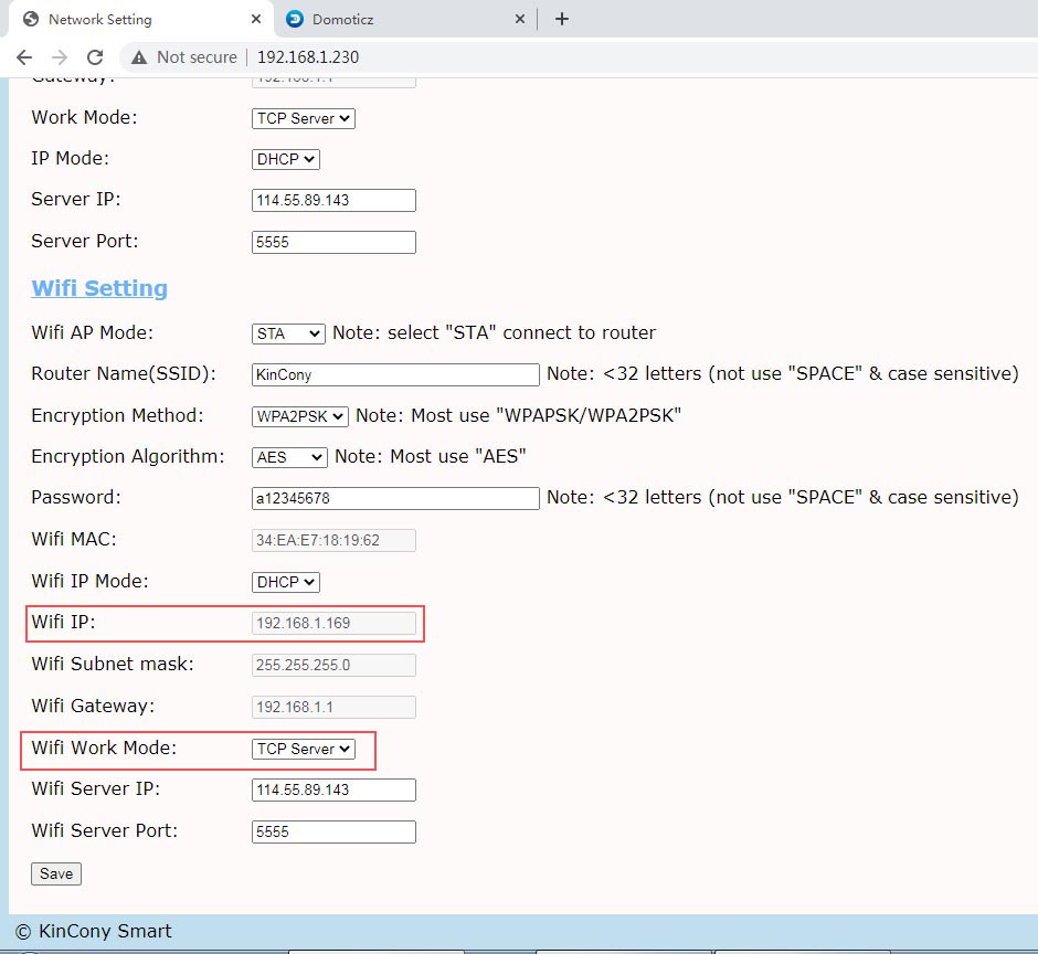

if you use ethernet port, find the Ethernet IP and Port in red box and make sure ethernet “Work Mode” is “TCP Server”.
if you use WiFi port, find the WiFi IP and Port in red box and make sure WiFi “Work Mode” is “TCP Server”.
