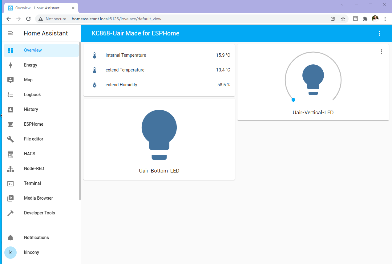

This is ESPHome configure for KC868-Uair smart home automation box. example for use inside temperature sensor (DS18B20) and extend temperature sensor (SHT3x) and WS2812B RGB LED strip.

# follow configure use for DS18B20 temperature sensor, SHT30 temperature and humidity sensor. WS2812B RGB LEDs.
i2c:
sda: 4
scl: 16
scan: true
# Example configuration entry
dallas:
– pin: GPIO27
update_interval: 15s
# Individual sensors
sensor:
– platform: dallas
address: 0xC000000004D81528 # your DS18B20 address
name: “internal Temperature”
– platform: sht3xd
temperature:
name: “extend Temperature”
humidity:
name: “extend Humidity”
address: 0x44
light:
– platform: fastled_clockless
chipset: WS2812B
pin: GPIO32 # Pin Define connected with LED strip
num_leds: 4 #LEDs number
rgb_order: GRB
effects:
– addressable_rainbow: ##defined 7 effects styles
– addressable_color_wipe:
– addressable_scan:
– addressable_twinkle:
– addressable_random_twinkle:
– addressable_fireworks:
– addressable_flicker:
chipset: WS2812B
pin: GPIO33 # Pin Define connected with LED strip
num_leds: 1 #LEDs number
rgb_order: RGB
effects:
– addressable_scan:
