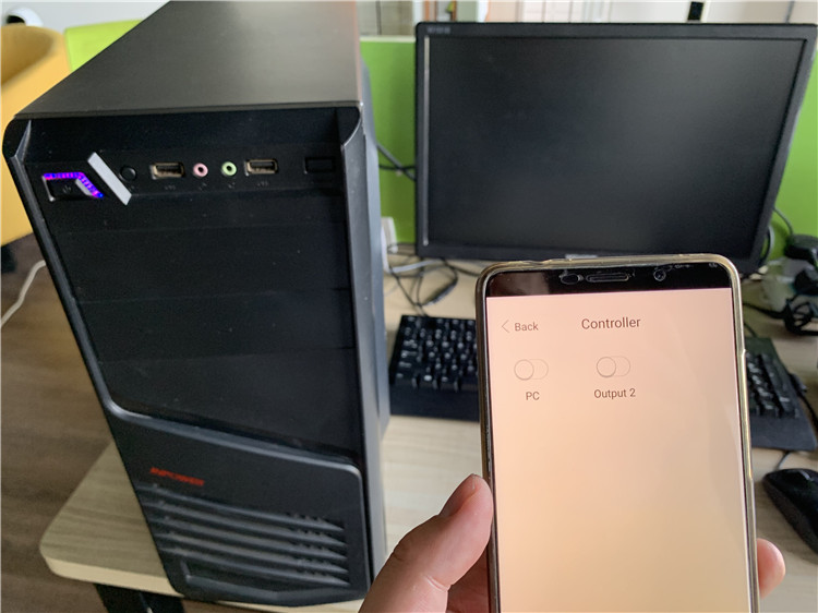

You can put the smart device inside or on the side of the computer case, to make it beautiful view and safe, convenient. After that, you can download the mobile phone APP and PC computer software from our official website.
We can customize the name of the key, e.g. PC for the first gang.

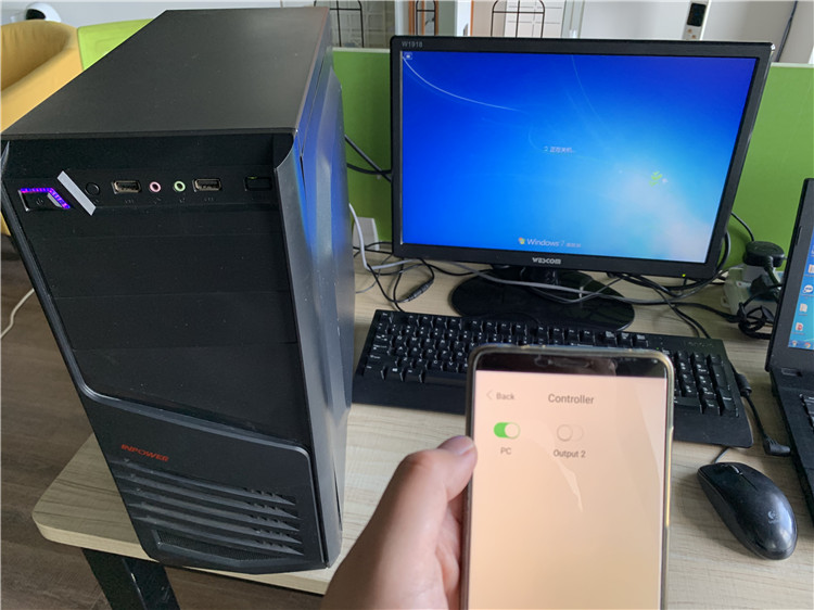

Turn on the button on the APP, you could see the computer had been opened and started into the system.
On the laptop, open the TeamViewer software, and input the ID and Password of the TeamViewer on the desktop computer, then the remote controlling can be fully executed now.
