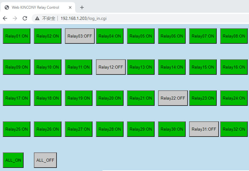

KC868-H32B relay controller support http webpage control. It can control by http command for software engineer.
firmware V4.0.1 improvement:
1. add relay control by webpage
2. support http command for developer integrate to third-party software to tun on/off relay and read relay state.
