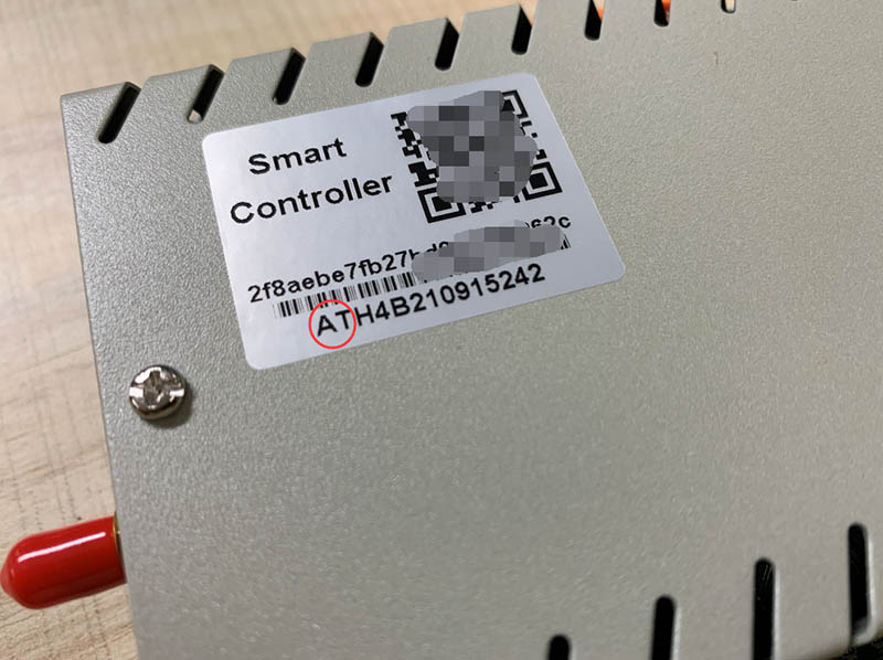

make sure your KC868-H4B metal box top lable have “AT” words, like this photo. so that have 256KB flash memory enough for update. If not use the MCU chip, if you can weld, replace the MCU will support new firmware.
