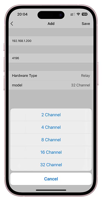

add relay controller according to IP address and Port. for example: add 32 channel relay controller by IP address and Port. relay board should enabled “TCP Server” work mode firstly. if you are using KinCony A32 Pro controller, just set “TCP Server” work mode in “KCS” firmware.
hold on the switch button, you can rename , change ico and work mode.
