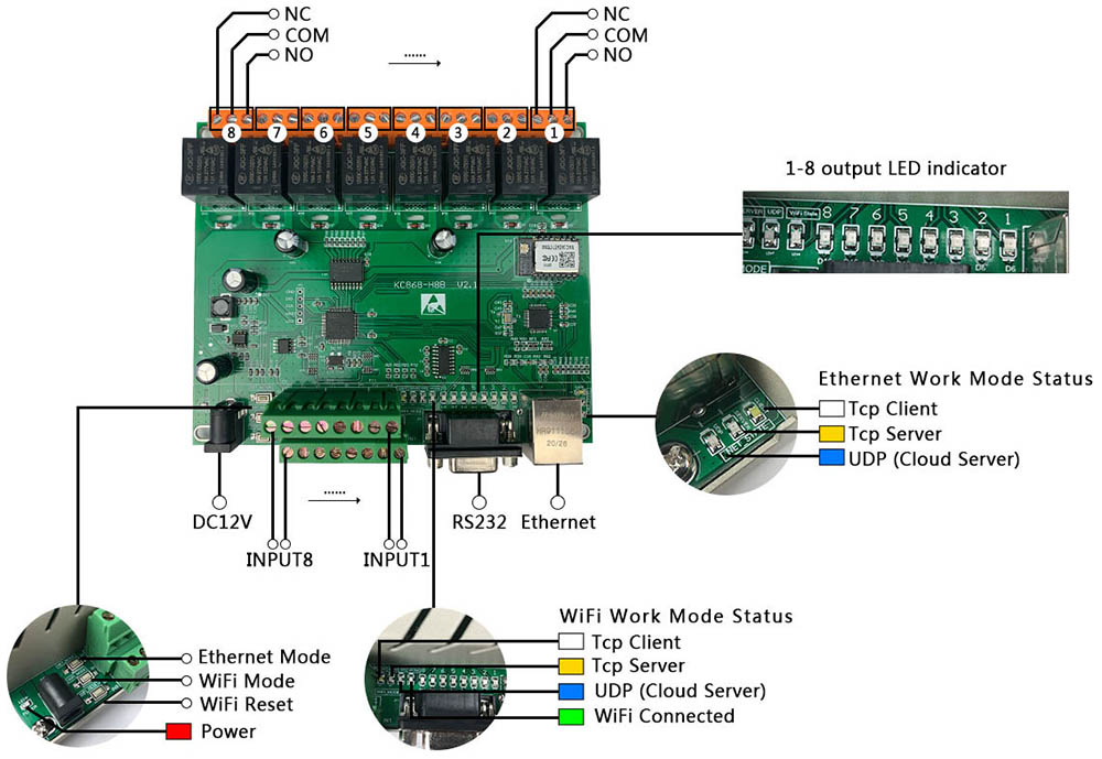

[vc_row][vc_column][vc_column_text]1.Diagram of relay Controller
A.KC868-H32BS
B.KC868-H32B
C.KC868-H16B
D.KC868-H8B
E.KC868-H4B
F.KC868-H2B
Led status different color means:
Red: Controller is power on.
Green: WiFi module is connect to your router successfully.
White: network run in “TCP Client” mode.
Yellow: network run in “TCP Server” mode.
Blue: network run in “UDP” mode.

what’s buttons function:
Button1 “WiFi Reset” : Reset WiFi module, then controller will be work as “AP” mode, you will see the wifi signal “LPT230” for use.Now you can config the ssid and password for your router.
Button2 “Ethernet Mode” : change ethernet work mode for UDP->TCP Server->TCP Client.
Button3 “WiFi Mode” : change WiFi work mode for UDP->TCP Server->TCP Client.
How to use buttons:
Button1 “WiFi Reset” : Hold on the button for 5 seconds,then restart power of controller.
Hold on the button until LED color changed. There are 5 status:
a.) Hold on button, when the [yellow LED] is ON, release it, then work mode in “TCP server” mode;
b.) Hold on button, when the [white LED] is ON, release it, then work mode in “TCP Client” mode;
c.) Hold on button, when the [blue LED] is ON, release it, then work mode in “UDP” mode;
d.) Hold on button, when the [yellow and white LED] all is ON, release it, then work mode in “UDP” and IP by DHCP mode;
e.) Hold on button, when the [yellow and white and blue LED] all is ON, release it, then work mode in “TCP Server” and IP (192.168.1.200) by static mode;
Note: after changed mode, the controller will restart automatically.
The controller default work mode is DHCP and UDP mode.
Hold on the button until LED color changed. There are 3 status:

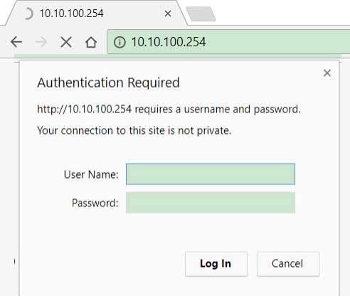

Let your computer to connect WiFi wireless network name of “LPT230”
When wifi connected, open browser visit: http://10.10.100.254/
input the user name: admin password: admin
now the default menu is Chinese , you can click “English” change to English language menu.

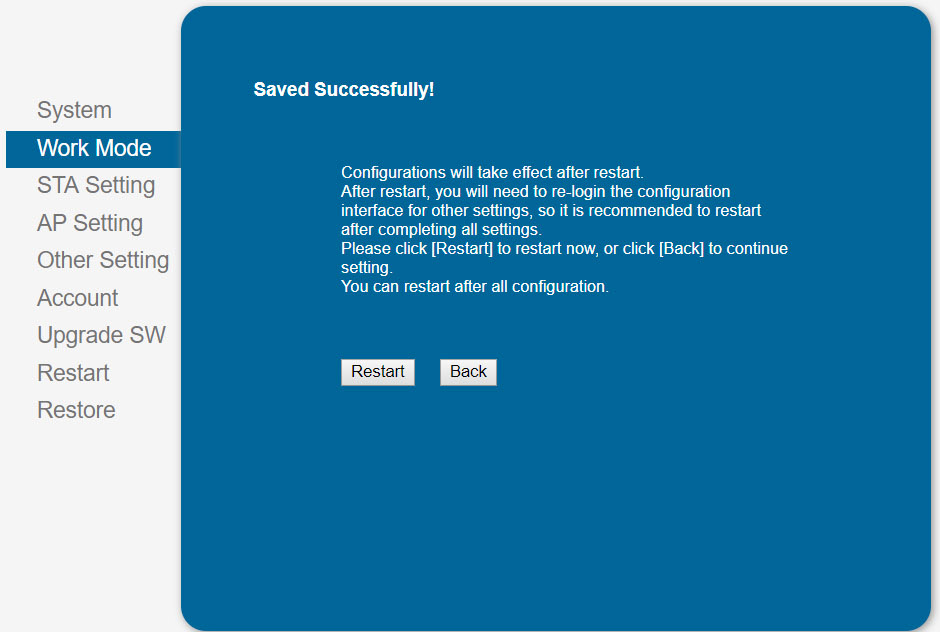

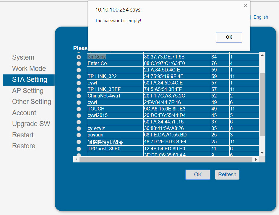

Enter wifi work mode, default is “AP mode”
Now we change to “STA mode”, “STA” means “Station”
not need to “Restart” , just click “Back” button for other settings, at last you need Restart once.

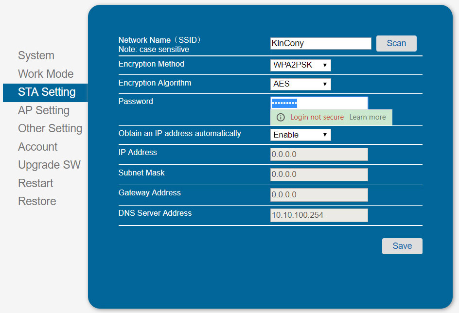

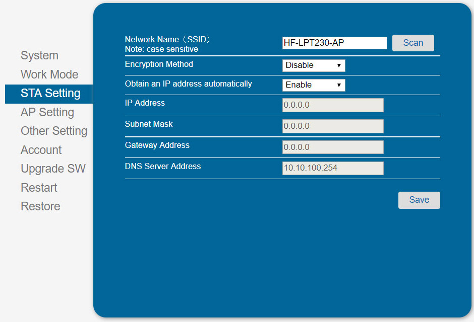

Press “Scan” to search your router’s wifi signal or you input manually.
Chose your router’s wifi ssid
there is a tip message for you to input password of your router.
now input password of your router.
also press “Back” begin for other settings.

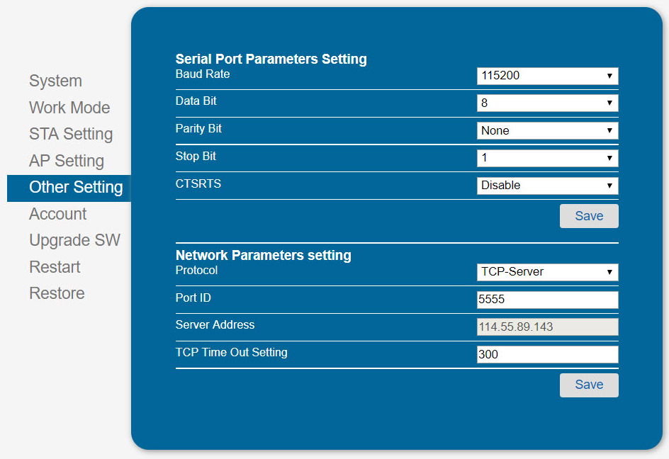

B.Set Work Mode for remote control (Need internet and KinCony’s cloud server)
now you want to use “KinCony smart home ” phone app for remote control, so make sure your Protocol line is “UDP” and Server address is “114.55.89.143”,Port is “5555”. now all setting is finished, we press “Save”, then restart.
now you can restart power of your controller. Now you can use “KinCony Smart Home” app and PC software for remote control.
C.Set Work Mode for local LAN control (without internet)
Just change Protocol = TCP Server after “Save” Re-start power for controller. Now you can use “KBOX Smart” app and PC software for local control.

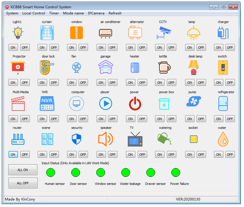

3. How to use Phone APP and PC software in WAN/LAN
Click below photo to see video:
A.APP- KinCony Smart Home (WAN:need internet)
B.APP- KBOX Smart (LAN:without internet)
C.KC868-H32,H16 PC Software (LAN:without internet)
D.KC868-H8,H4,H2 PC Software (LAN:without internet)
